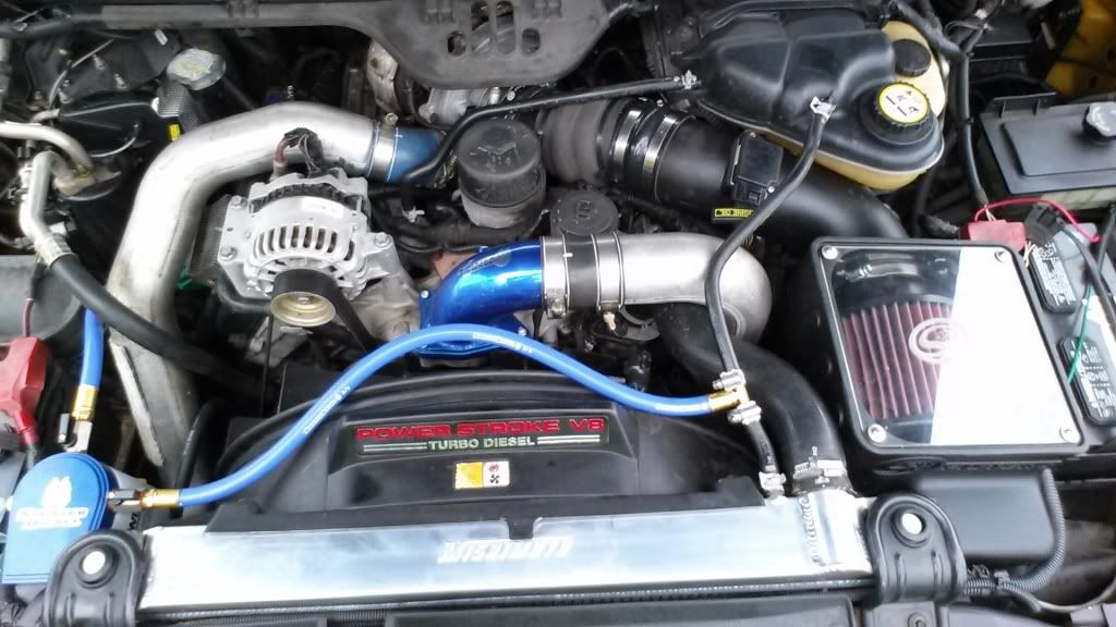

I jumped on it, the truck was towed here because it didn't run, and hadn't run for 2 years. I ended up throwing a set of batteries in it, just to see if I could diagnose the issue with our IDS computer.
As soon as I put the batteries in, the truck fired right up. I went ahead and changed the oil and cleaned the fuel tank out since it had been sitting for so long. The lift pump was weak so I installed a FASS Titanium 150 instead of installing another factory lift pump.
I drove the truck for several months and was really enjoying the 24 mpg that comes with a Standard Cab 2WD.
After a while I noticed the truck was skipping pretty bad in the mornings, I started saving up for injectors. I have watched hundreds of customers replace one injector at a time, there's no way I was going to tear this thing apart 8 different times. I ordered all 8 injectors, a Bullet Proof Diesel 58 volt FICM and a regulated return kit.
With the new injectors and fuel components installed the truck freakin' RIPPED!
I had the first small taste of 6.0 performance and decided to go against my initial decision to leave the truck alone.
I ordered the SCT 5015 so I could keep an eye on the engines vitals, like ICP pressure and FICM voltage etc.
I also installed an S&B cold air intake and sent the EGR the way of the dodo bird.
The truck was ridiculous. It put a huge smile on my face for the first couple of days, but then I started realizing it wasn't much fun trying to feather the throttle pulling out onto the highway, trying to keep the truck from spinning in circles.
So I got rid of the pizza cutters that were on it and threw on a set of Drag Radials we had at the shop. It would stick awesome, but those tires are sketchy in the rain. After a couple races with the other guys here at work I noticed the radiator was leaking. Not bad but I hate leaks, so I ordered the Mishimoto all aluminum radiator to get away from the brittle plastic end tanks.
That's pretty much were the truck sits for now. I don't want to push the stock head gaskets anymore, the truck has 320,000 miles on it and stock head bolts.
I want to spend the next year truly Bullet Proofing this engine. Front mount oil cooler, billet water pump, head studs, O ringed heads, auxiliary transmission cooler, and back halving the rear end are all on the list. Most of the parts I need are already here sitting in our warehouse. I just have to find the time to do everything without holding up a lift required for customer's trucks.
