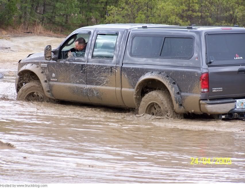

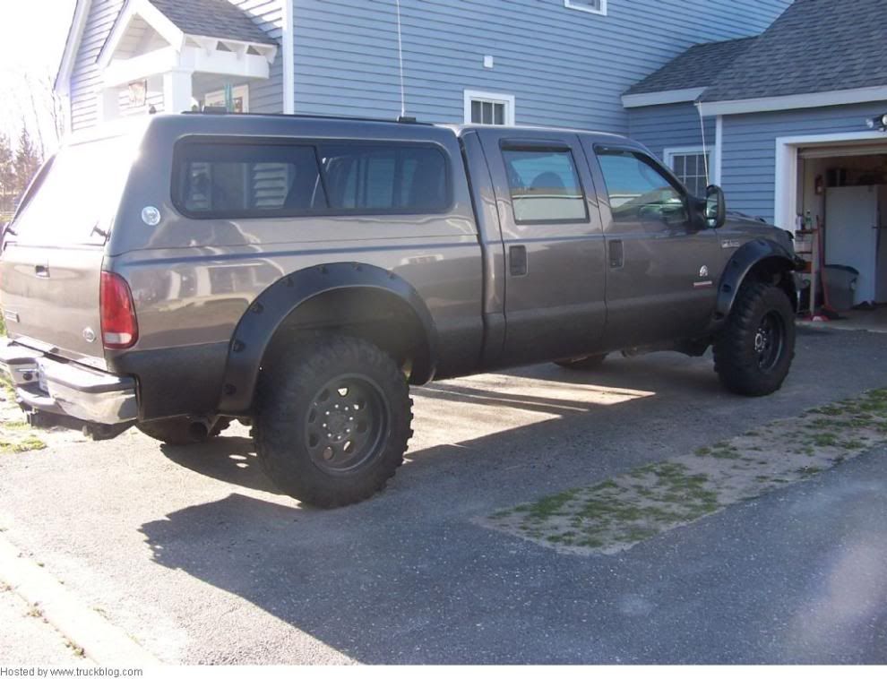

"WOULD YOU LIKE TO EXPLAIN THE PURPOSE OF THAT"
I would love to explain.....
You'll get people that will say "I fit 35's on mine,..it only rubs a little bit"
To me,...If you say "it rubs"...then that means it doesn't FIT!
My truck 2005, Stock height, 36's and Cut-out Bushwackers....no rubbing....but I could've put 37's on it
20 x 10 AR Mojave Teflon wheels w/4.5" BS

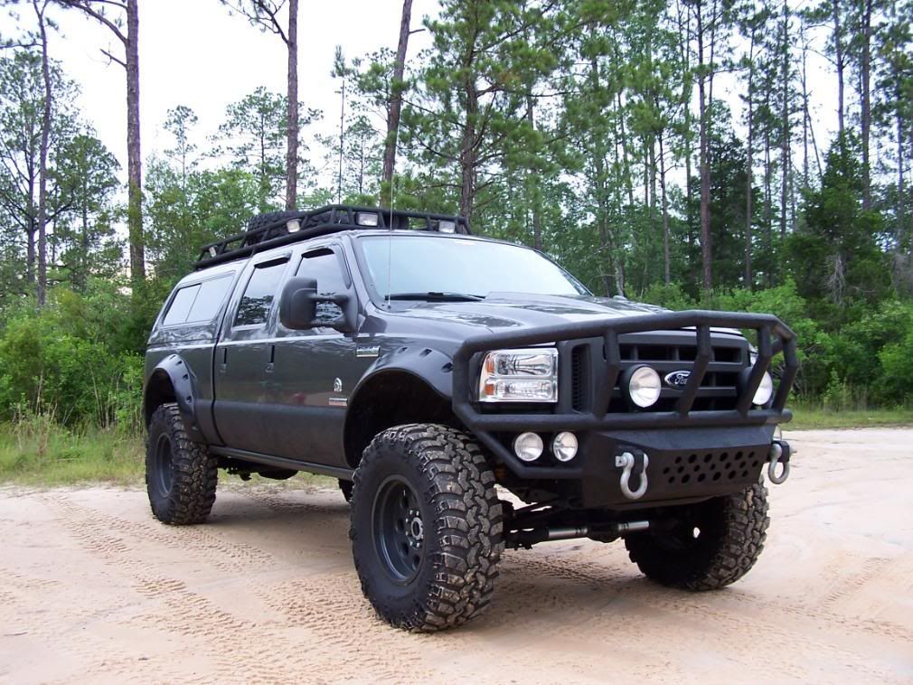

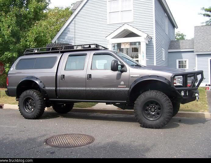

My truck with 4.5" lift, 39.5" Iroks...no rubbing

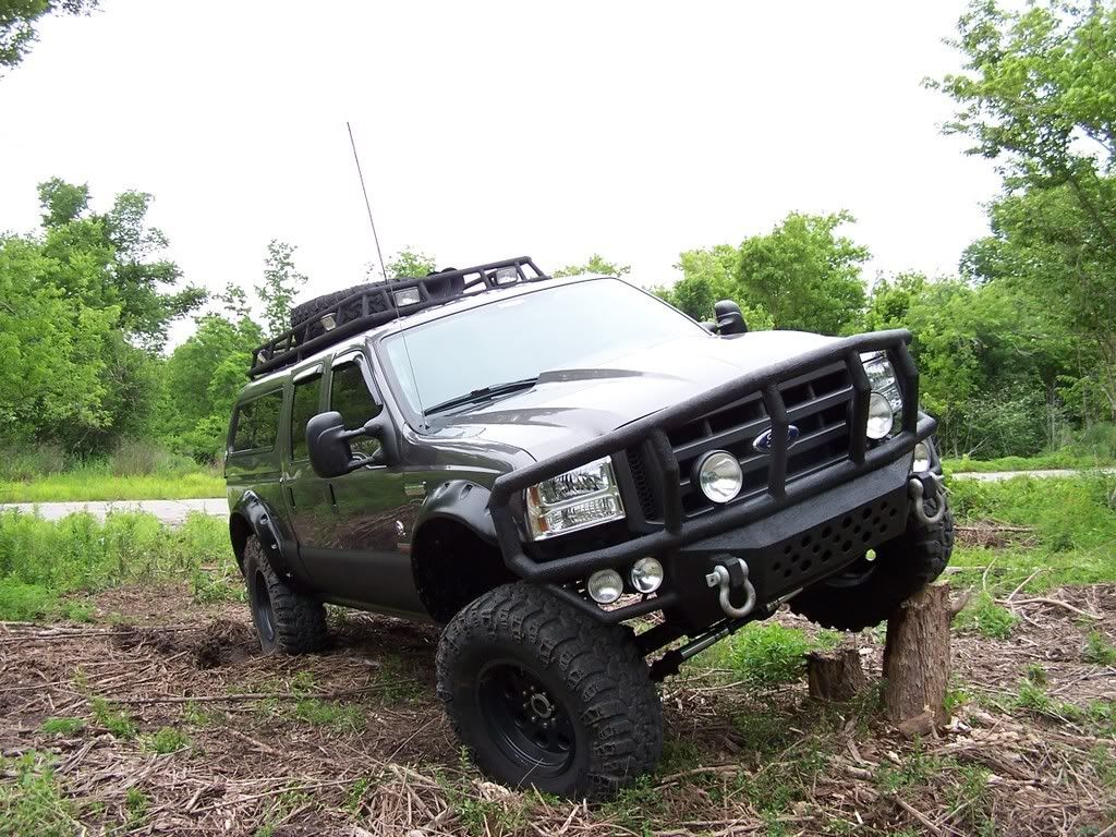

My truck with 4.5" lift, 41" Iroks.....very very slight rub on radius arms
That is what I meant by "if your willing to trim sheet metal"
Because.....it makes a big difference...and because I put on the Bushwackers,...
I have a lower center of gravity.
I don't have a steep driveline angle(vibes)
I paid half a much, because I didn't need a huge lift to clear the tires.
Normally you need 12-14 inches of lift to clear 41's....I have the best of ALL worlds.

Wow, how did you fit 36's??? I could only get 33's on my stock truck and they even rubbed.
Old 07-12-2008, 02:02 PM
Location: Belle Chasse
Posts: 3,445
....go back and RE-READ the entire thread..
My truck, Stock height, 36's and Cut-out Bushwackers....no rubbing....but I could've put 37's on it
