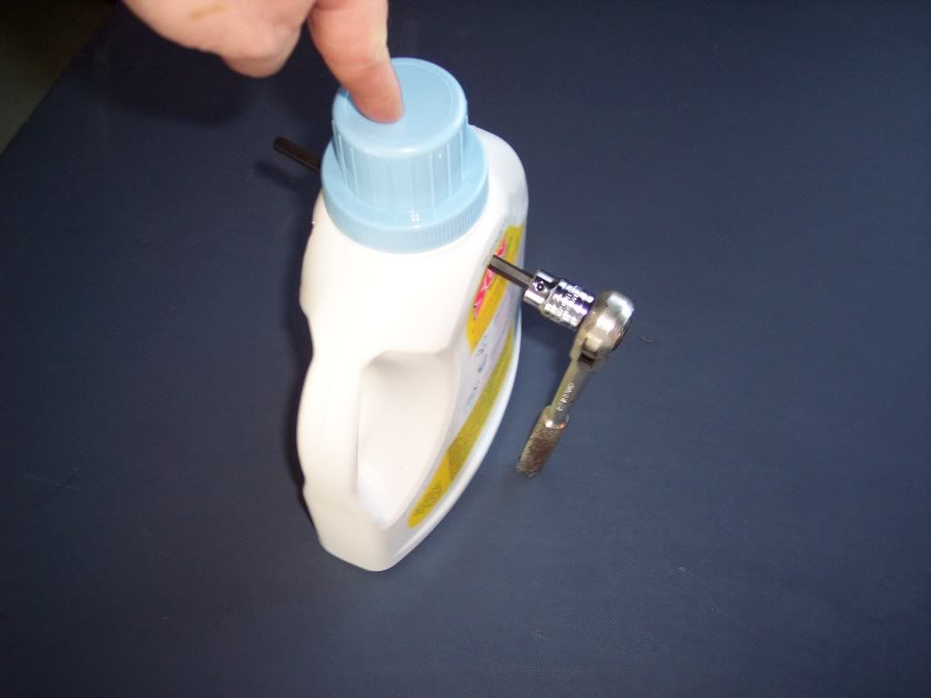

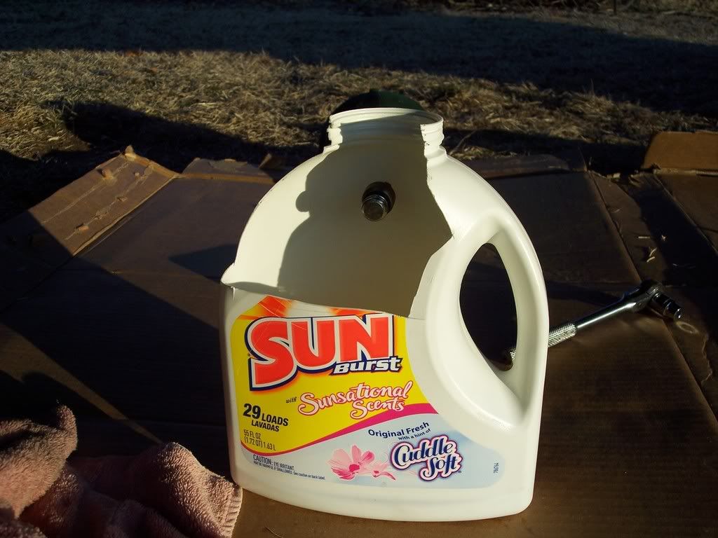

i heard that the drain plug will leak all over you, so i fabb'ed this catch bottle with my 6MM 6' HEX wrench to go through it) so it does not spill on me.
but i had to do further fabb'ing (see PIC) but it Worked like a CHAMP!!!!!!!!!!!

next remove the drain plug as you see here PIC
then my lil catch can will catch the fuel/water crap
(NOTE: see drain plug attached to the HEX head still)
