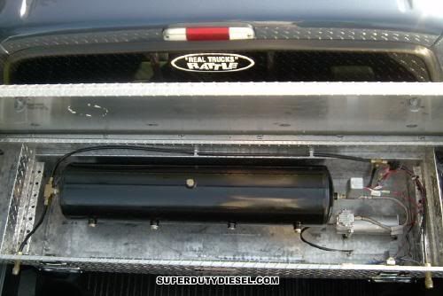

Here's my pics.
Removed the spare tire (where else you gonna put these mutha's)
15 gallon tank and ViAir 450 continous duty mounted in the toolbox
also have a 5 gallon mounted on the frame (sorry no pics)
