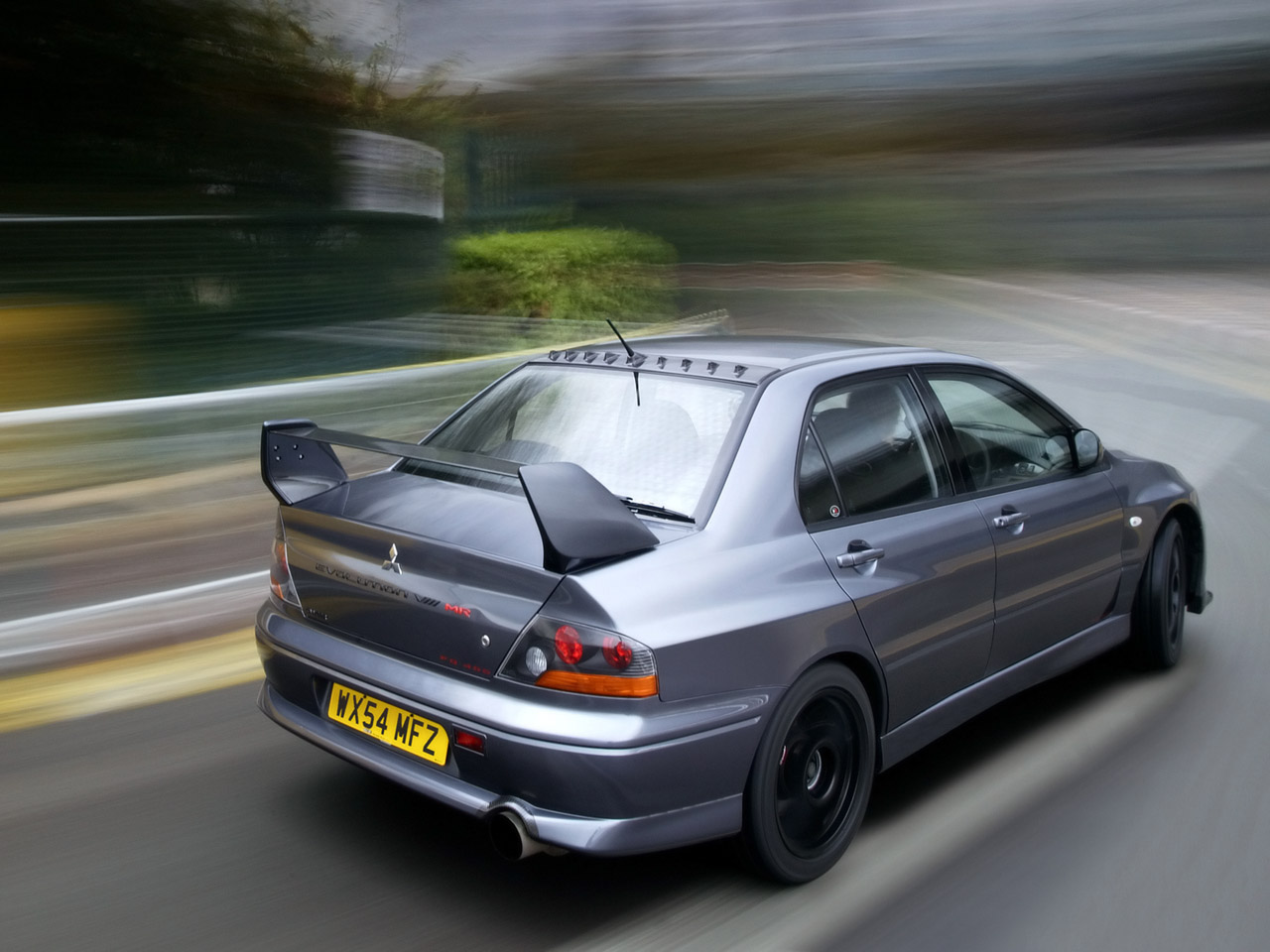

Interestingly though, this isn't new tech and it's not unfounded. This was last used (that I know of) on a production car, the Mitsubishi Evo MR to redirect [turbulent] air from the roof to the rear wing.
From autotitre.com

Boat tail or teardrop projectiles have an aero advantage due to reduced drag. If you look at modern fuel efficient vehicle design, projectiles, motorcycles, golf clubs... just about anything moving fast through a fluid (air is a fluid), then you'll see a form of boat tail design (optimal angle for "break away" is about 7° from the previous plane).
Golf balls generate pressure zones around them due to the dimples. There is something to gain from just the basic dimples on a golf ball though that has some advantage even in static form like a wrap. I just don't think it's enough to use it.
Dimples work well on rounded shapes. On more "slick" surfaces however, you're more concerned with skin friction drag.
Interestingly, on these types of surfaces the devices that you originally pointed to are used to generate a similar effect than that of the golf ball dimples (turbulence needed), the term for them is vortex generators. I think Mitsubishi even used this term when describing the fins on the back of the Evo 8.
