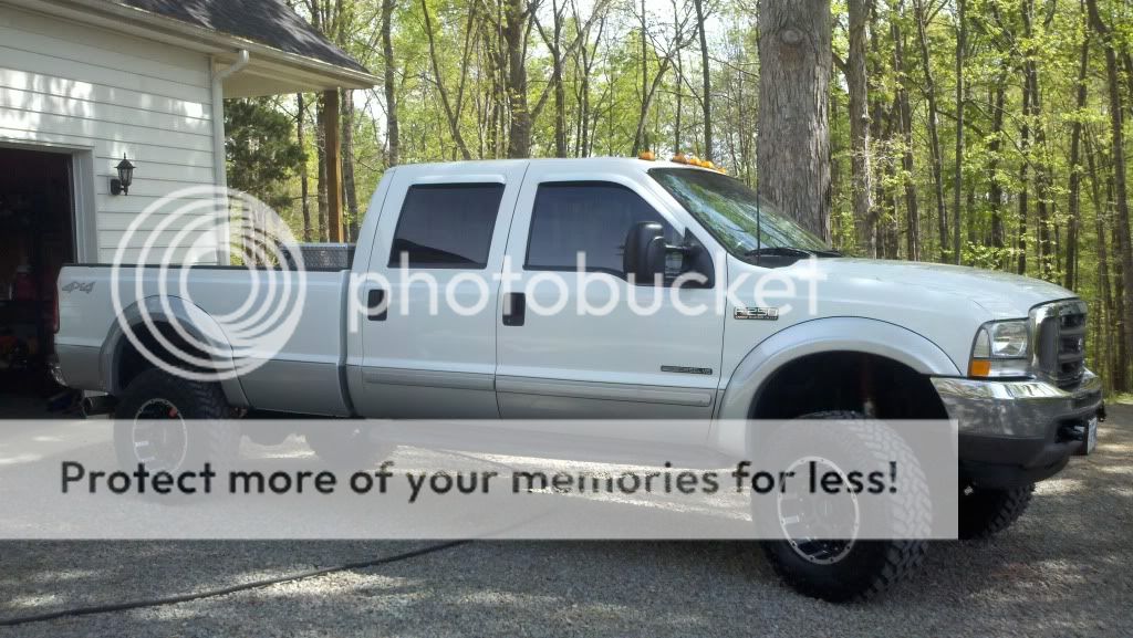

After two weeks I'm 90% done.[IMG][IMG][/IMG][/IMG][IMG][/IMG][IMG][/IMG][IMG][/IMG][IMG][/IMG][IMG][/IMG]

Cool. At least you used a 24V and not a 12V
Looks like you were able to keep basically all the radiators in place.

Sweet build, are you using the stock tranny with adaptor or aftermarket tranny? Whats the reason for swapping? blow the 6.4 or just something different?

What are your plans for the cummins? Leaving it stock?
Assuming he used a destroked trans adaptor.

Well it's on it's second engine and we are tried of the problems, And yes it's a adapter plate from Cummins conversion sp. we used the stock 5R110 with a PCS controller. Does anyone know how to fool the check engine light ( resistor,etc) ?? it's the last part left.
