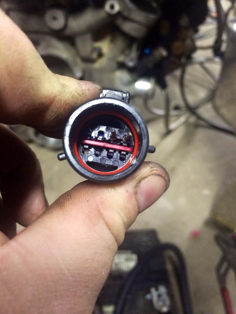

On the passenger side fender well there is a harness that the factory dual alternator plugs into. When you remove the second ALT the harness needs to come out too.
It plugs in right here.
Those of you who don't have a second ALT will see a little "loop back plug" in the end of the harness. This is what you need to replicate with the factory dual ALT harness.

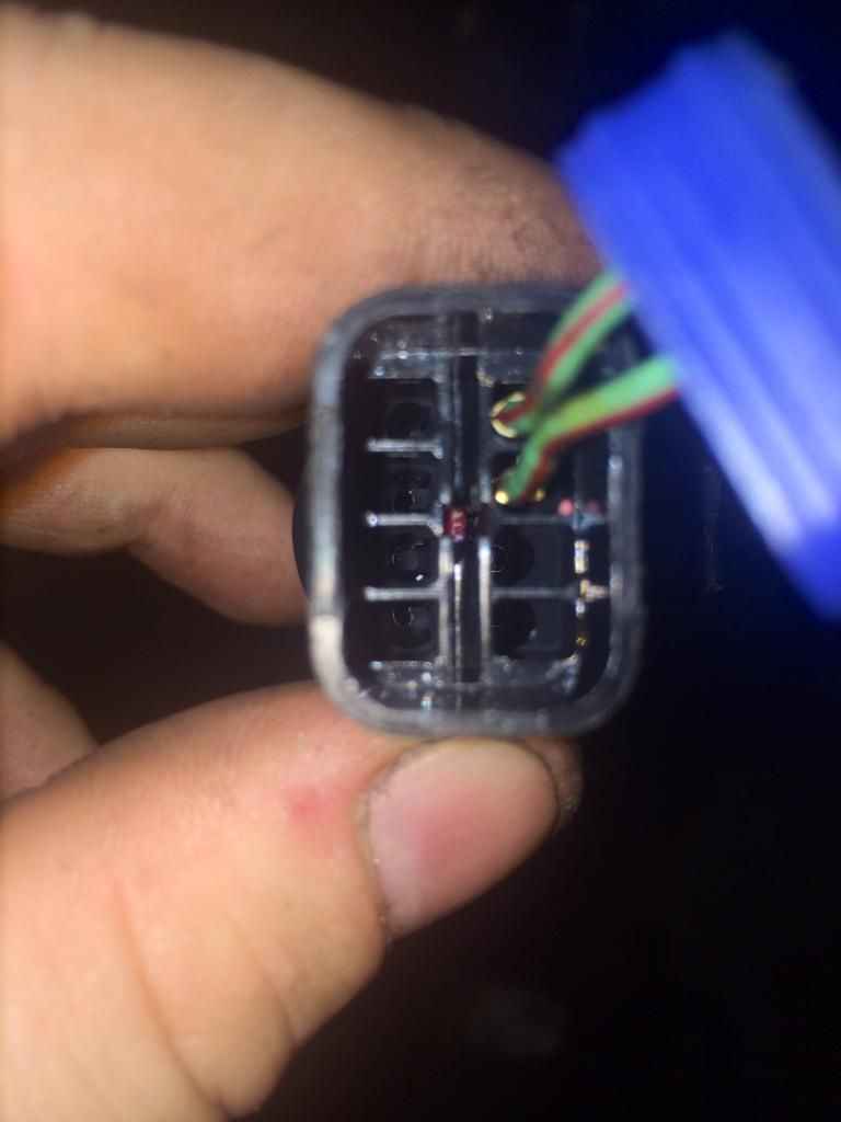

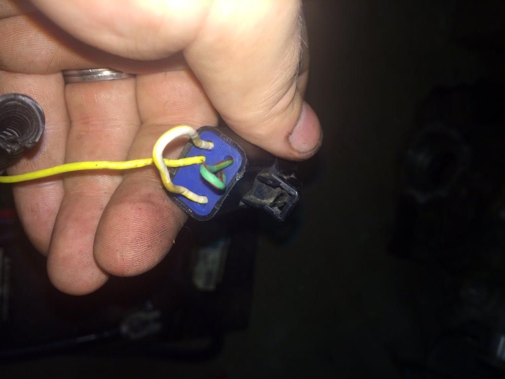

Remove the old harness and find the plug that looks like this.
I had already modified this one before I took this pic. But the green loop back is what you need to worry about. You have to change the pin out locations for the green wire and remove the others.

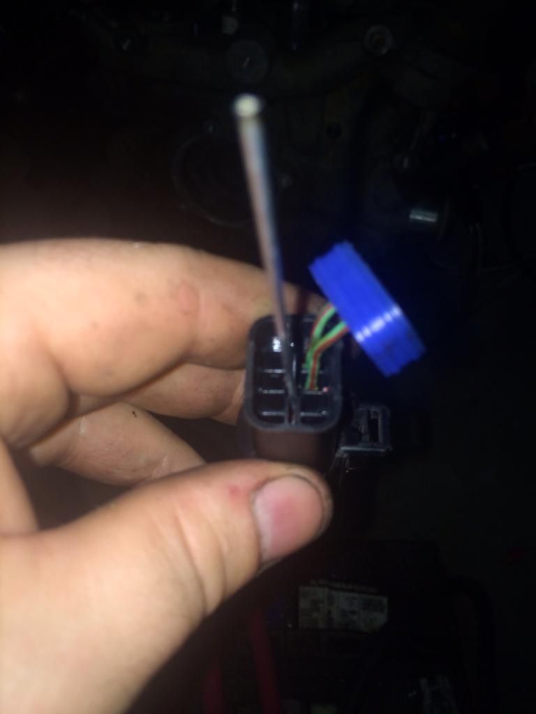

To do that you need to take and pull the rubber stop out so you can access the release pin.
I used a piece of 1/16" tungsten to push it out.
Once you have removed the red tab, proceed to remove the other wires and pins and put the two green pins in the location you see here, then button it back up and plug it into the factory harness along the fender well and you are DONE.
