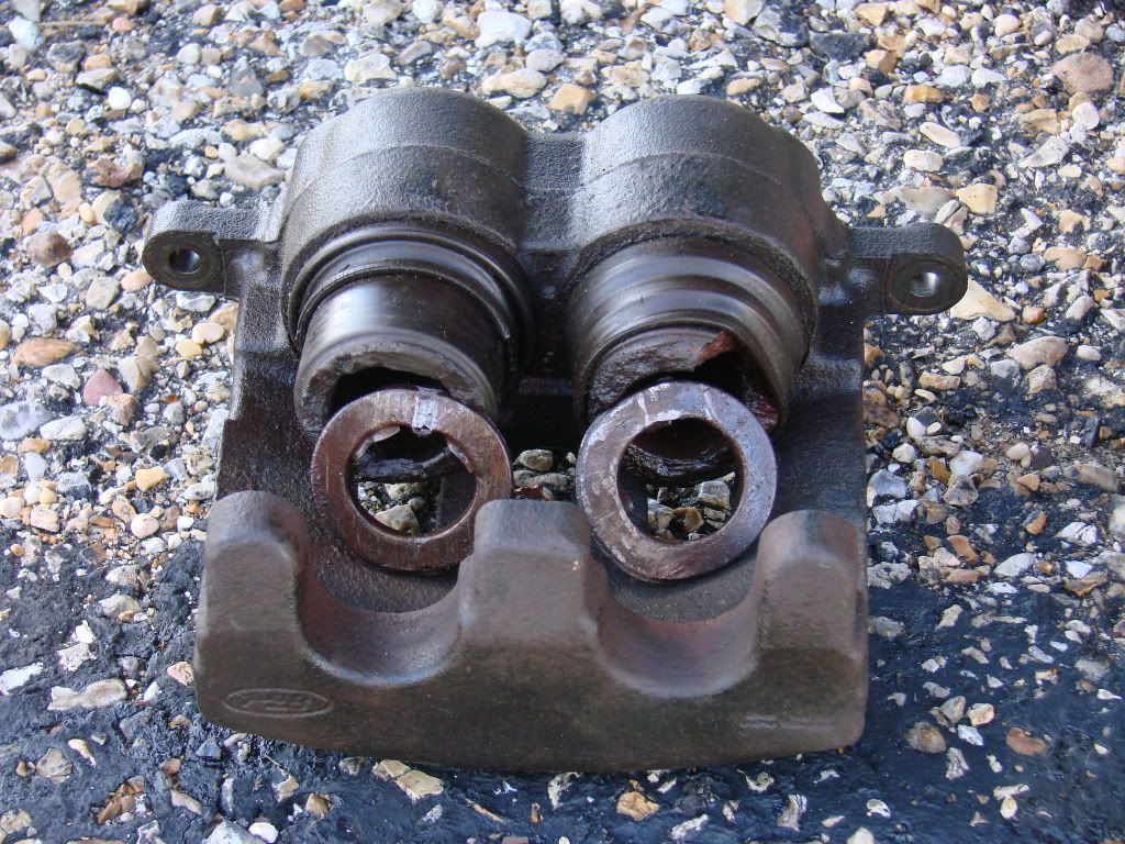

So, I tore down the right rear and saw the carnage. It had chucked the inside brake pad and wedged it between the dust shield and the rotor. Then, with no inside pad, the caliper pistons were cracked and eaten up badly by the rotor.

The screwed caliper

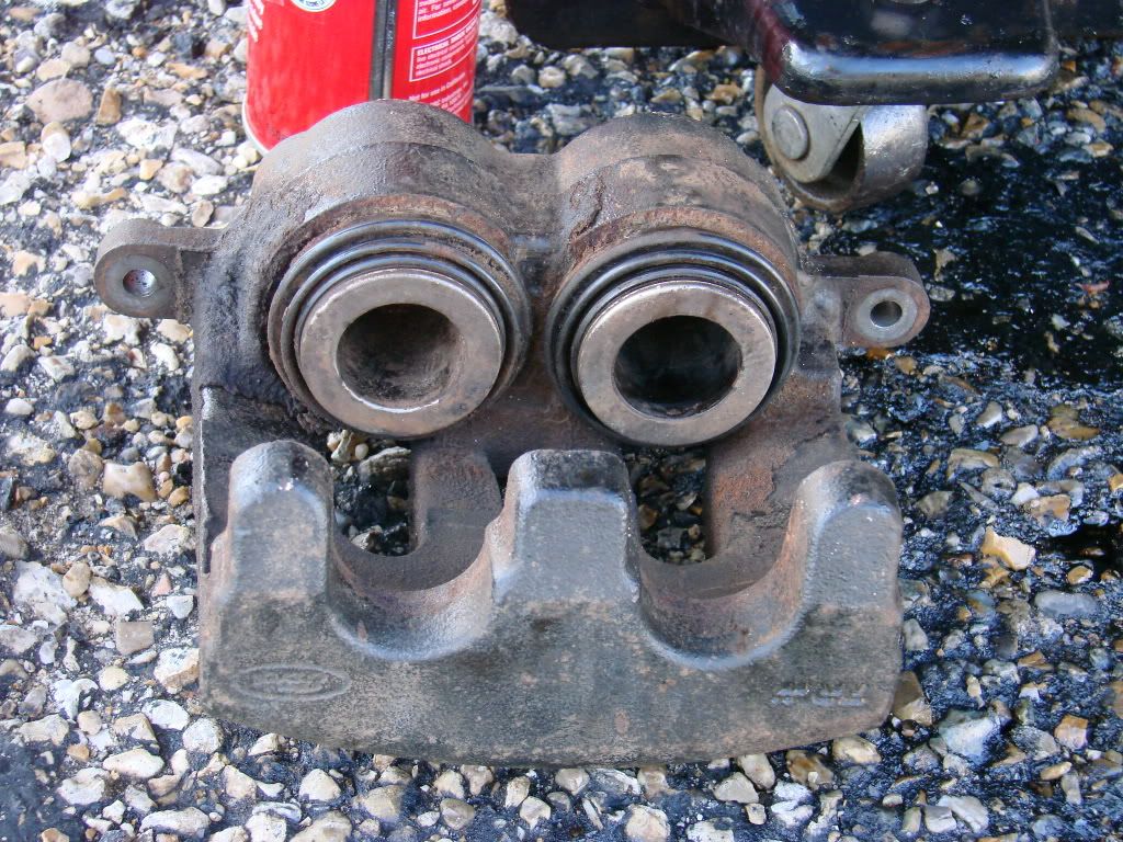

The caliper from TANK's parts truck

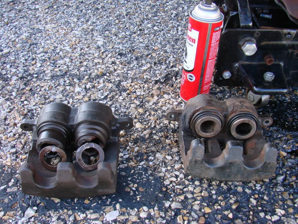

Both calipers side by side: original on left, TANK's on right

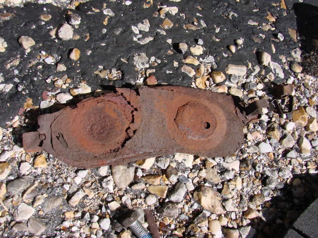

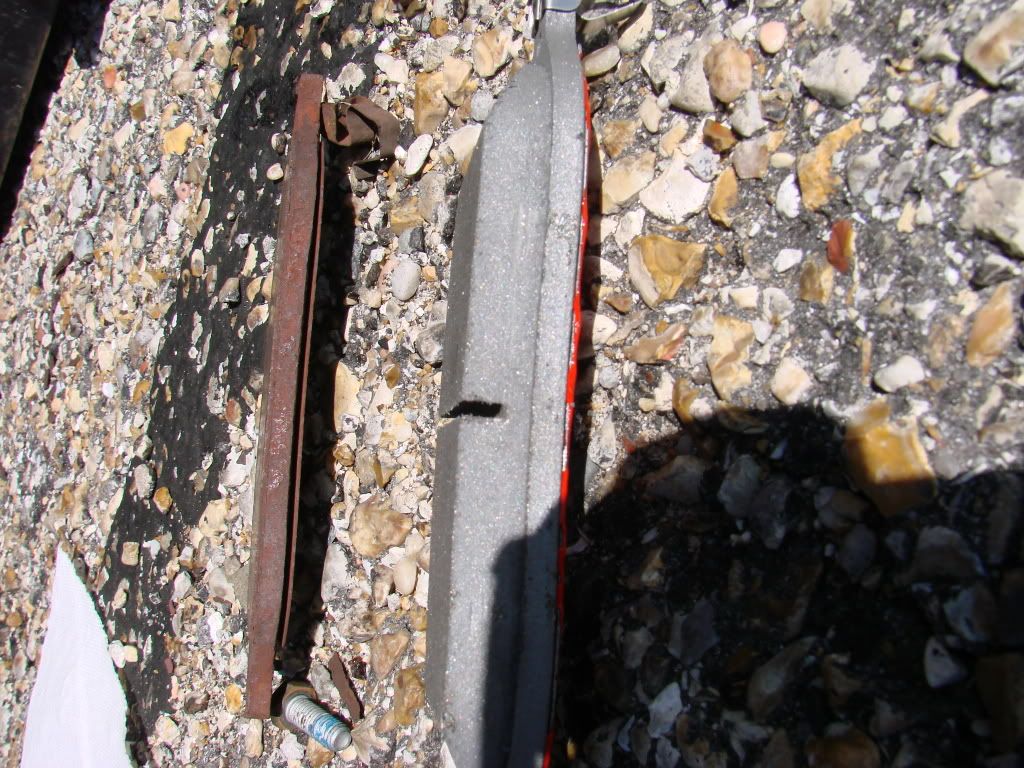

I think it was time for new rear pads. This is what they looked like with only 50,000 miles on the truck. I'm pretty sure I utilized the full usefull life of this pad; there's practically nothing left on the backing plate.
This is the pad that got chucked and wedged between the rotor and the dust shield. I think those pads had a slight rust problem from the truck being owned up north for the first 20k miles of its life.
