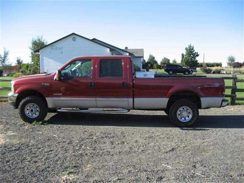

DuraWhat, I have 2.5" spring packs made by Tuff Country on my rig. I went with this kit because it included the track bar relocating bracket. Not all brands include the track bar bracket. Here are some pics.
Tuff Country Spring Pack
Before
After Installation
