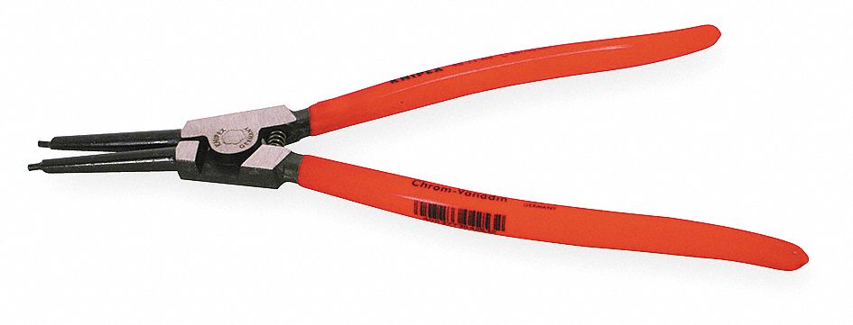

Oh I now have more snap ring pliers than anyone I know I finally got a set from Grainger that worked ,, the interchangeable ones were to fat and some were to wimpy
luckily I wasn't under the gun to find a set that would work since I was just doing a vacuum seal
