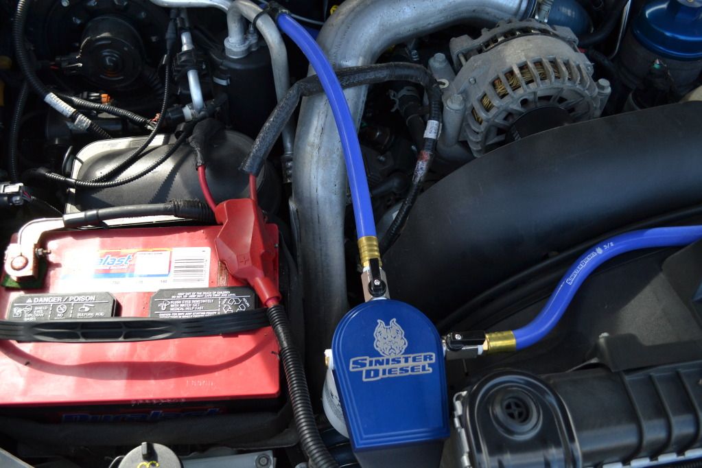

I also have two alternator, IMO your not really putting any noticeable load on the motor with the second alternator. I would just leave it on there and upgrade your top (primary) alternator.
When my original top alternator failed, the secondary was there as a back up and didn't leave me stranded or out of commission. The PCM turned on the "battery light" in the dash, but my volts still showed 13v+ because the secondary had been commanded on by the PCM.
http://www.ford-trucks.com/forums/at...8&d=1288282883
