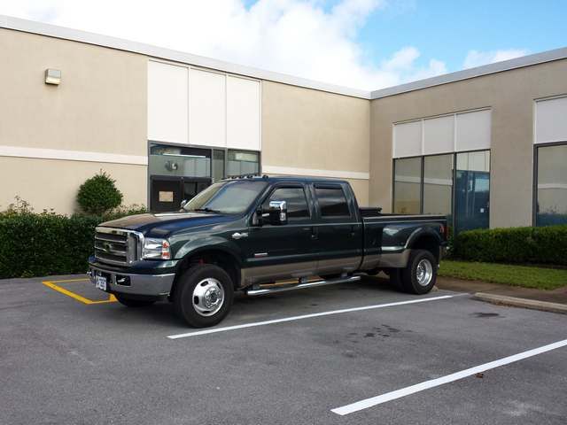

This is the pickup that I hauled.
I am pleased to say that there was only two times on big hills that it hit 1250.
I think that I can live with that!!!
