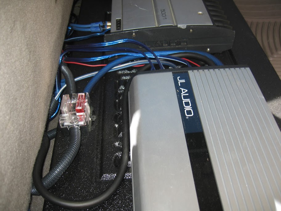

Since I will be hitting the interstate more frequently in the future, I figured it would be a good time to upgrade the stereo system and add some video for my two boys in the rear.

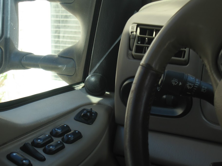

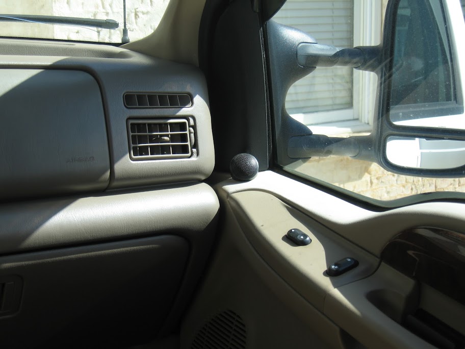

I completely bypassed the factory wiring with 14 ga. since outboard crossovers were used in each corner (Cerwin-Vega Vmax 65 components) running on a JL Audio JX360 4-channel amplifier. I have a Probox 8" subwoofer enclosure (Probox 09F35018L-400) (Probox Amplifier Rack F250) behind the rear seat running on a JL Audio 500/1 monoblock amp. All power and ground wire are 4 ga. with fuses and a distribution block. The amps are mounted on a Probox Amplifier mount and looks very, very nice in the truck, as well as top notch fit and finish. Plus, everything is made in the USA which is always a plus - he same can be said for JL Audio. I had a brain fart when I was outlining the back trim piece for the subwoofer. For some reason I did not account for the hump toward the middle and ended up cutting it out - I will modify it in the future when i get a chance
I already had a Pioneer DVD head unit, so I was able to hook up a rear LCD screen for the kids - it broadcasts to wireless headphones as well. I also have an Ipod Classic hooked up tot he head unit with about 80 movies. The system is already setup for a PS3 and power inverter which will go in soon.

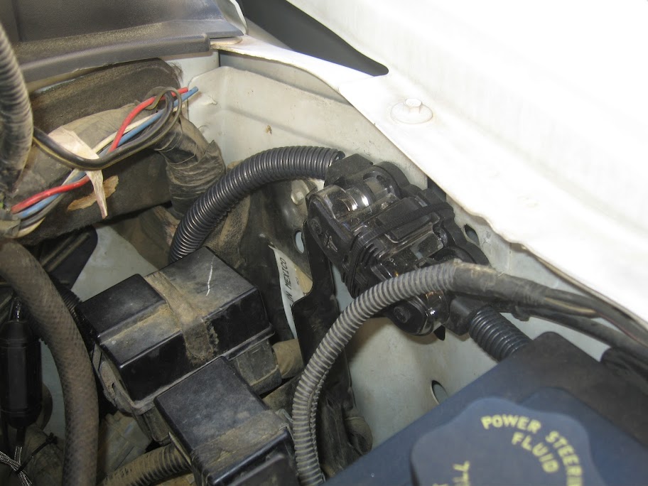

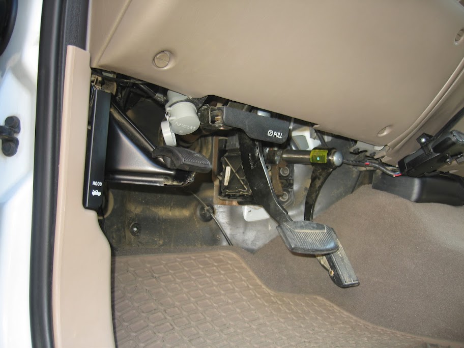

Also, I installed the Ravelco Anti-theft system, minus the wire splicing. the unit is installed through the firewall and taped up, as well as wire conduit. All I need to do is figure out which circuits to tap into. The hard part is done.

Good idea on the ravelco. I had one installed in my 97. The inventor Vinny actually lives down the road from me. He installed it himself. How hard would you say the install was for yourself?

My opinions on this install and what i might have done differently. If you don't care what I have to say then skip to next post if so then read on.
If you are going to run the tweeters in the rear doors it would be beneficial to run the driver in the rear door as well. Imaging would be way off. Amp rack looks good (clean up the wiring and zip tie everything). When putting round speakers in an oval hole you sound always make or use adapter plates like these.
