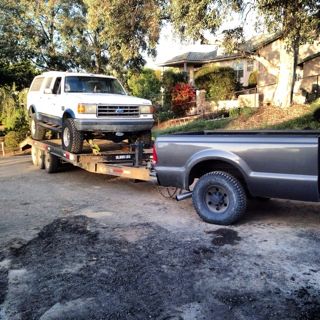

That's a good looking truck.

Thanks man, bought it for $7500 and put the lift and everything on last weekend.
