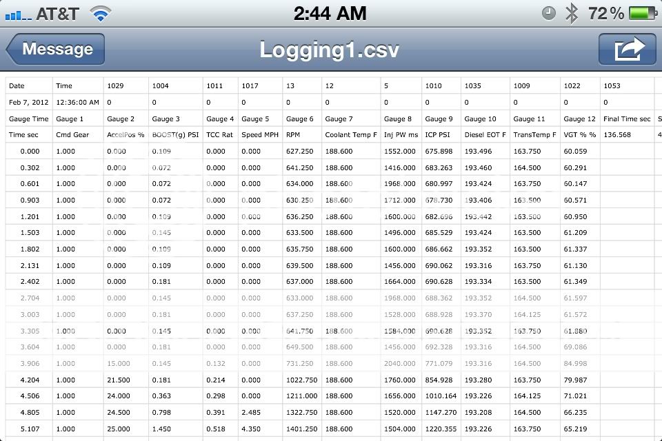

With a touch of the screen, you can start data logging which ever parameters you have set to watch. After you have data logged and saved the file, you can review the file right on the iPhone/iTouch/iPad, even if your not connected to the truck. When reviewing your data log, it will be in a graph form. At the bottom of the graph is a "Time Line", with a touch of the screen you can see exactly what the parameters are reading at that given time, then slide your finger to read the settings thru-out your logging. You can also send the file to an email, it will show up as a CSV file already organized in columns (see pic down below). This data log feature can help trouble shoot issues.

And here is pic of what the emailed CSV file looks like.
