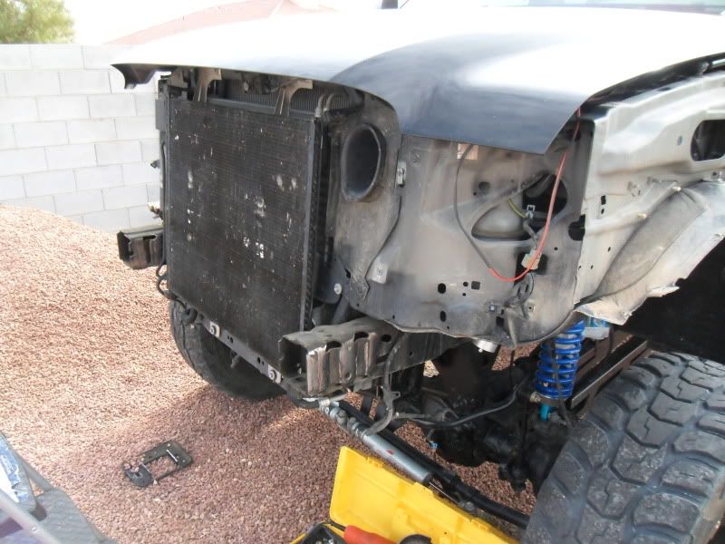

For the front, tear it down, fenders, hood, grille, bumper, the fiberglass grille support and headlights, the wiper cowl, wiper motor and transmission .. all of it
Next should be the fender install.... but first i wanted to prep the frame for welding because i have a friend helping me this week do frame work.. the bottom line is an 08 bumper needs to mount 2 inches lower then a 99-07, some guys have cut the frame different ways... I am going to mount this bad johny, so I am trying to do a professional custom fab:

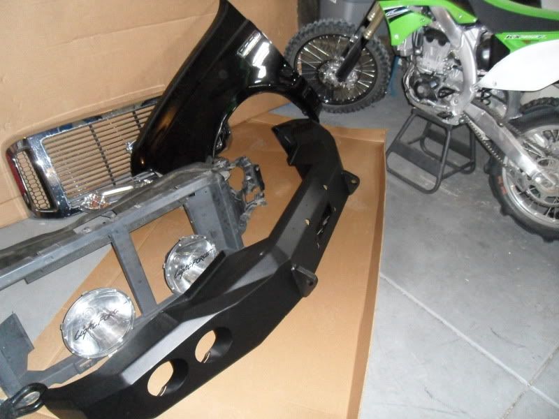

Road Armor Stealth for 2008-10 Superduty
So to do this, i cut off the frame plates to expose bare frame: this is how the end of an 08 frame looks, they dont have the plates welded on like we do, an 08 has half a plate and its bolt on, not welded...:

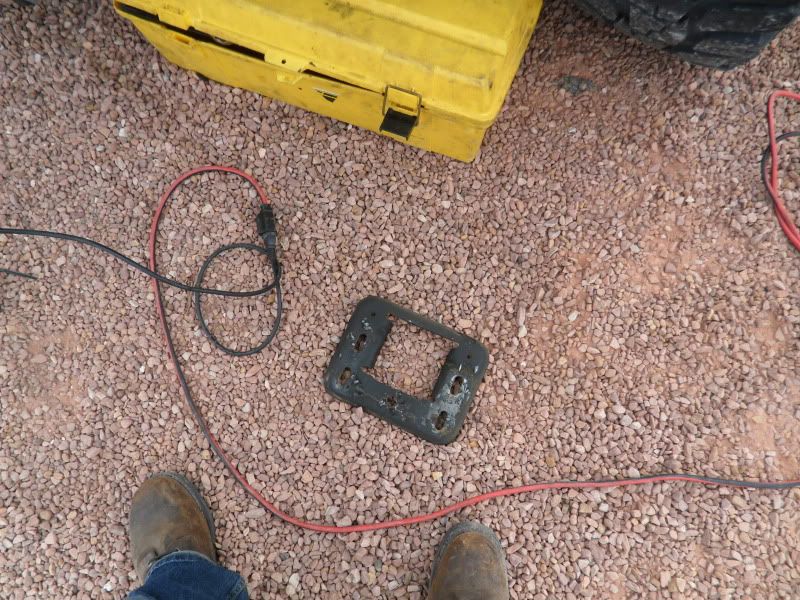

The plate i ground the welds and knocked off:
and this is the bracket that will make the end of my frame match up to the road armor, need to mount it about 1" lower then flush with the top of the frame, It is sitting on frame upside down right now, just so i could show it, the top is open and would not rest on frame as it is right now, so i just flipped it upside down to give a general idea... i dont think i will have to notch the frame at all, just weld this bracket underneath witch provides 2" lower mounting holes, the top of the road armor bumper should sit flush on the top of the frame rails( ie. inside top of bumper will be resting on frame rails) then box and gusset it:
