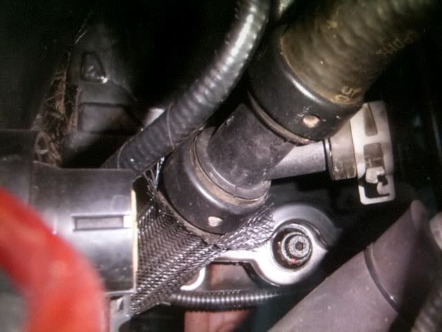

Old 06-01-2010, 07:25 PM
Join Date: Jan 2010
Posts: 36
pic of my studs
06   How to tell if head studs were done-100_5829.jpg can you see these bad boys
Old 06-01-2010, 07:35 PM
Location: Alabama
Posts: 5,387
Feedback Score: 9 reviews
Here's a better pic:
I love my studs
