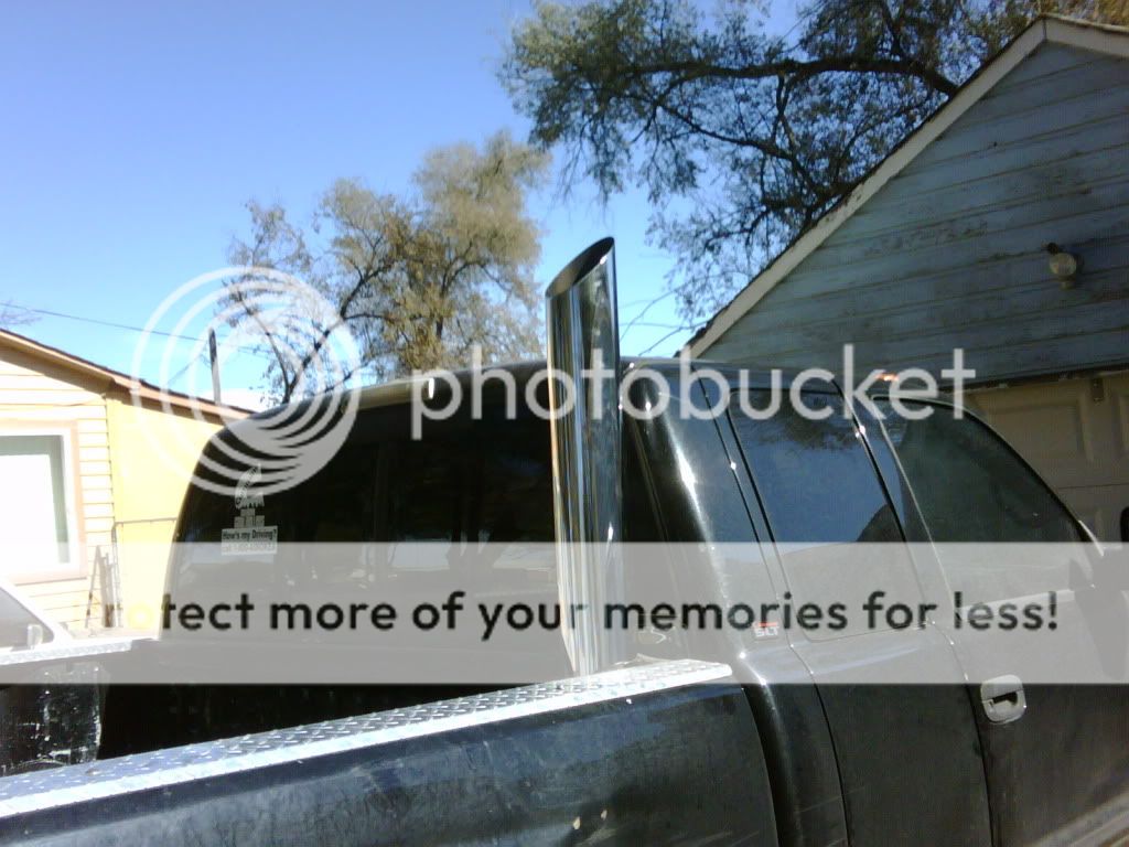

Just For The Fun - Here's My Old Ram...Last time I Hit the Dyno with it, I was right around 460 Horse @ The rear Wheels...Mind too, I re-did the Transmission, Valve Body and So forth...Kinda Had to LOL! I DEFINATELY DO NOT Trust The Dodge Transmissions!
Stack - 5" Miter, Single
I Took off This Stack, After I Smushed it into the Box Pulling a Horse Trailer LAst Summer...I Like The Black Bull Hauler Though...Used it As my Main Exhaust for a while...Then Got the 5" Miter...It too was a 5"
