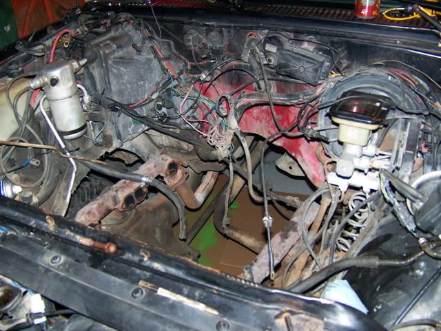

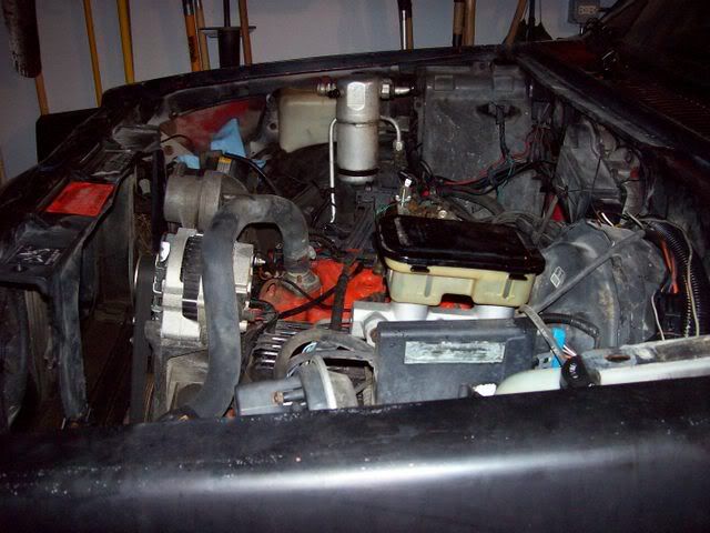

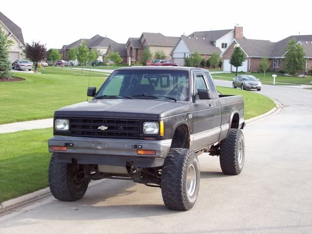

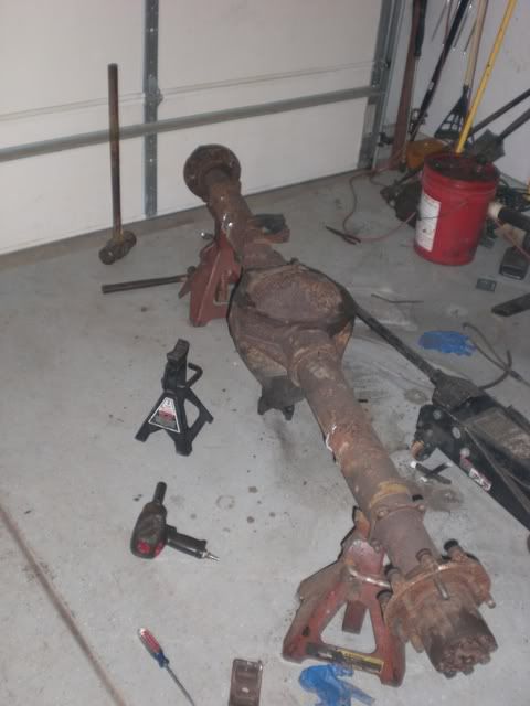

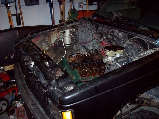

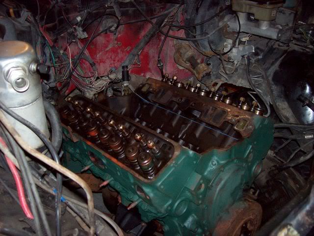

Well I am Finally Posting my build up. Here is the specs on When it is done. Then I will show what I have done , and have been doing along the way.
89 S-10 Extended Cab .
350 TBI
700R4
231/300 Home Made Doubler.
D60 3 Link With PanHard
18" Sway Away Air shocks.
4.10s , Lockright Alloy USA Shafts , Longfield U Joints. Full Hydro .
D70 Rear , 4.10s 35 spline beef , Rear disks , welded.
Running H1 12 Bolt Double Beadlocks , and 47" Ltb's

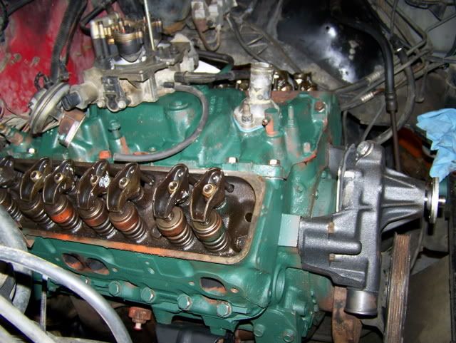

I bought it with a blown motor , so got a 350 for it , and threw it in.

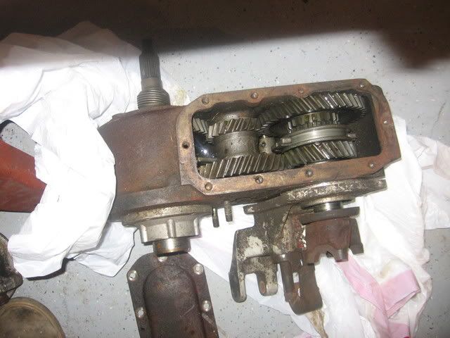

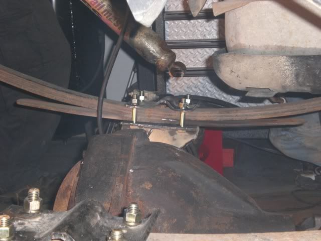

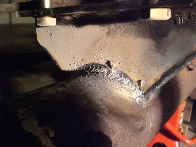

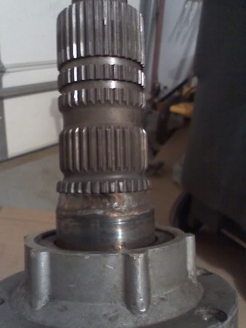

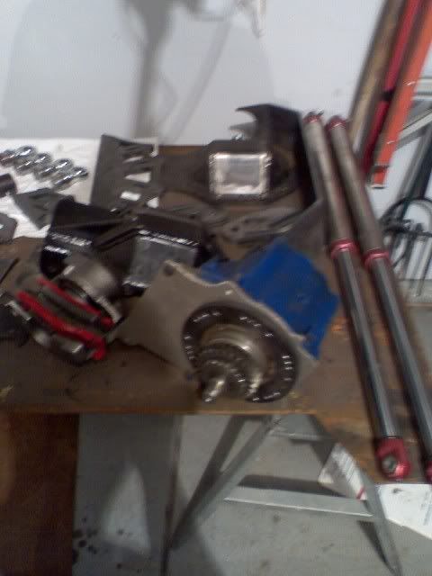

Little update. Been acquiring some tooling ,and working on misc stuff. Here is what I have been working on .

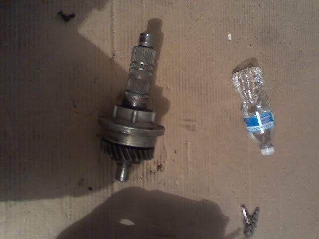

Doubler Had a friend weld a block off plate in , and cut a plate for the doubler. Need to call madrooster , and get a shaft ordered. Other than that I need to cut the center , and drill some holes. Started working on building a bender , almost done with it just need to finish boring some holes.
I finally bought a tank for my welder , and got a plasma , and it is great.
This weekend I also bought 5 Hummers , and Tires (to cheap to refuse, and seeing as I am dually F/R . )
Doubler stuff....

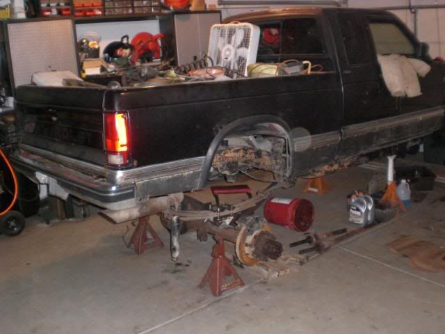

Rear sitting on tires. It is rediculously soft....

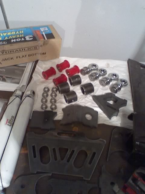

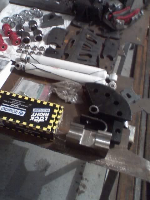

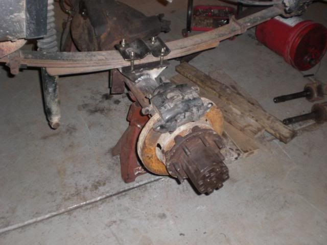

I have my doubler just about done. I keep recieving parts to do stuff , but have been short on time. Here is a few pictures.
Sorry for crappy pics... Cell phone .
Doubler is home made. More pics later.
So far the parts list is as follows.
GLO Diff Covers
Sniper Fab rear 4 link kit (Brackets)
Shocks
Air Shocks
High Steer Arms
GLO Clocking Ring
Doubler
Bender Die
Calipers
Brake Pads
Lockright.
Heims
Poly's
Tube Inserts
H1 Beadlock Inserts
Gonna order a double ended ram this weekend , or next week once I get an answer to a tech qustion. Also ordering a Steering Valve From Midwest Directional Services.

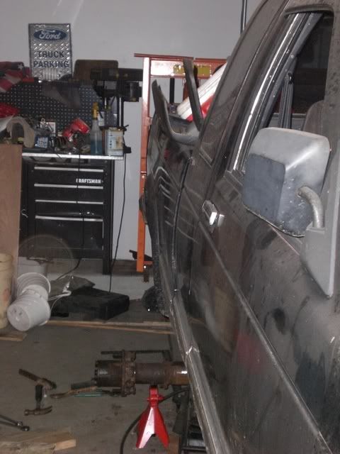

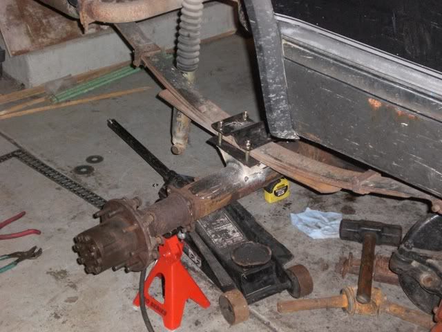

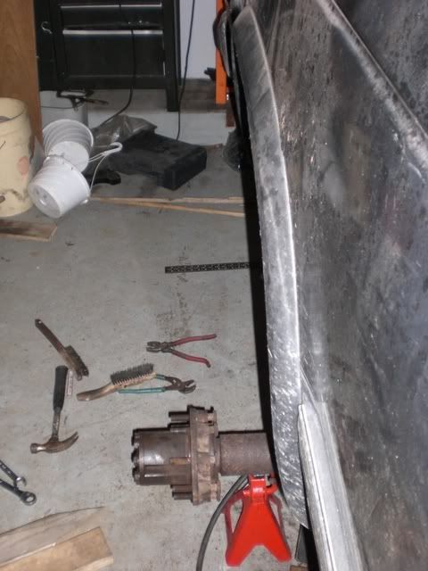

Well been making slow progress , waiting for parts. This weekend the plan is to blaze through the links ,and get the full hydro all done . Then make some Cross members ,and other misc things. Anyways I will update as I progress hope she is sitting on tires tomorrow night. Today we started at 4 made some decent progress but called it a night after the cops showed... Here is pics...
Started out by chopping the front of the frame....
Temp X Member..
Frame Chop time...
