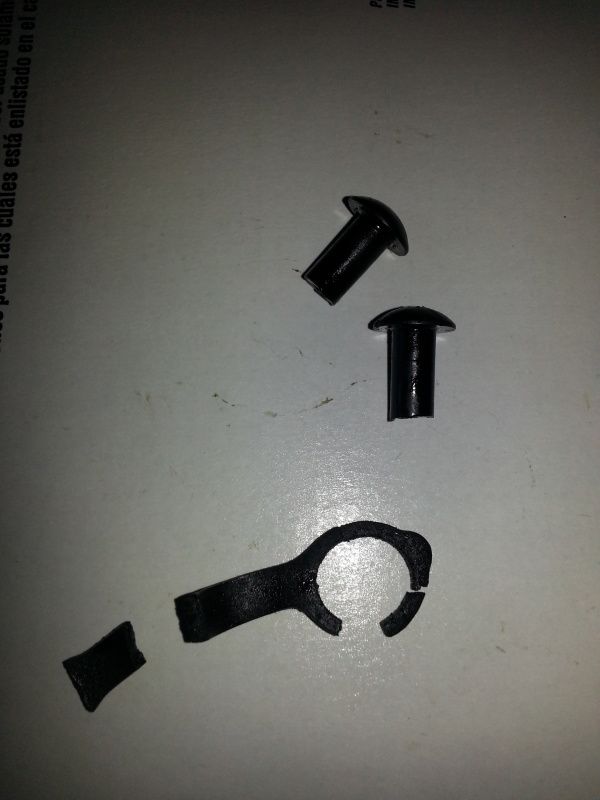

This is my problem.....pulled the Oil filter housing off and found these plastic pieces sitting in the bottom :
(diffent angle same pieces)
(different angle...same pieces:
I have no idea what they are...where they came from??
I'm getting close to putting the truck back together but need to know if anyone has seen something like this. If not...how did it get there? Dip**** Ford Mechanic drop something in there? ( You wouldnt believe it...FORD ASE mechanic left a intake bolt loose...had RTV on the rubber seal to the oil pump cover too, left the valley a total mess...you name it!)
To my Belief I think the no start condition was caused by the Ford tech. not cleaning the valley and debris getting into the Oil cooler and IPR, also the STC fitting was the upgraded one with the bracket but seemed like the bracket did more harm than good IMO.
I also want to add that my Antifreeze looked like brand new and oil was black like diesel oil should be. Degris bottle was a little low but clean as a whistle.
Anyways.....Help is greatly appreciated!!

OEM filter?

I had a WIX filter and cap on it but have since reading all the threads about aftermarket filters i got a OEM Cap and Filter to go back in.

WOW you edited your original post with a lot more info ,,,, I have to go back and reread LOL
Chit filters .. the only thing else would be check the drain back valve at the bottom (it lets the oil drain when the cap is unscrewed and relieves the pressure the filter is pushing on it .. also their is a plastic piece at the top of the tower
make sure everything looks OK I don't recognize any of your debris ,, but I haven't ever looked real hard at the tower (stalk )

The drainback valve is in perfect shape and seems to operate like it should. I even pulled it out and checked to make sure nothing was in it.
