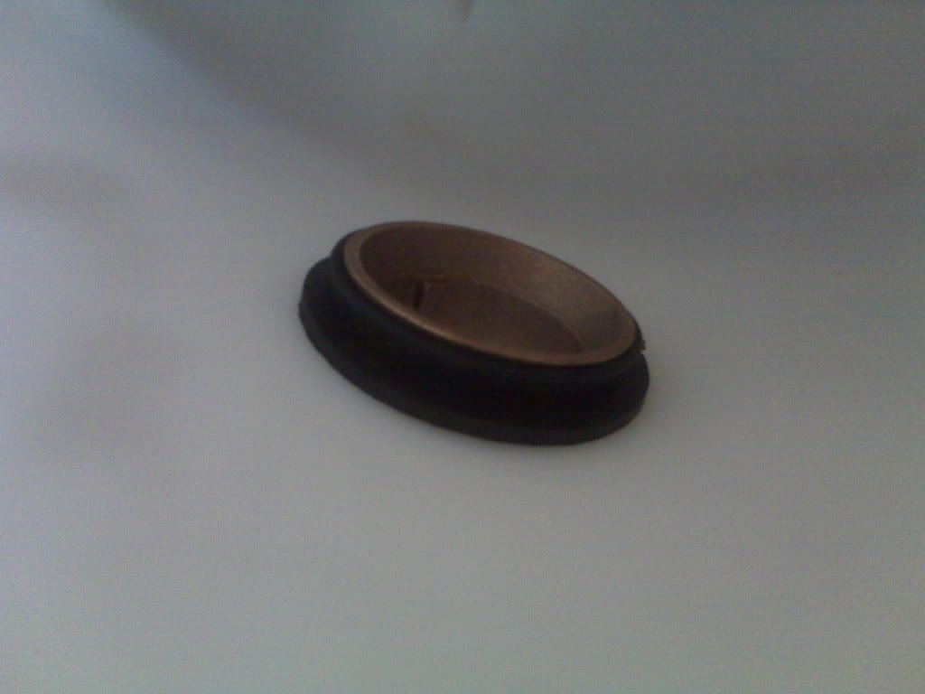

Here's what I have put together so far. I wanted to get the tank finished first so the oil would have time to settle after it got stirred up. Had a hell of a time with my valve. I got an adapter but the hole i drilled was SLIGHTLY too big, so while wandering around the hardware store mad, I saw a 2" "Closet Spud" and it fit perfect! the gasket was nice soft rubber, no leaks so far! I used a strainer from walmart for the top, im thinking of getting some cheese cloth to put in there also.
I'm gonna plumb the 2 filters tomorrow. Im gonna use to plumb in my pump so when it blows, wont be such a pain to replace and ill have the flexibility to use a different size pump.
