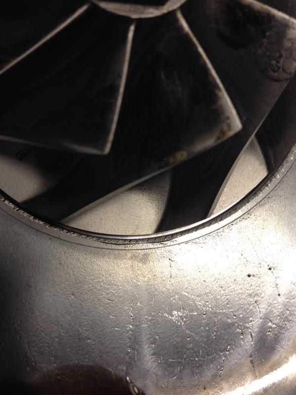

Some scratches around the edge of the wheel.

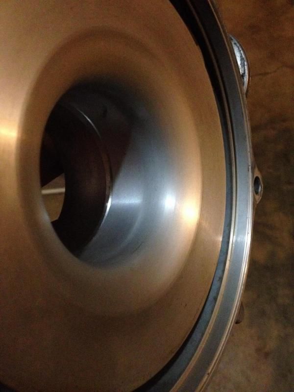

No signs of the wheel hitting Compressor housing anywhere..

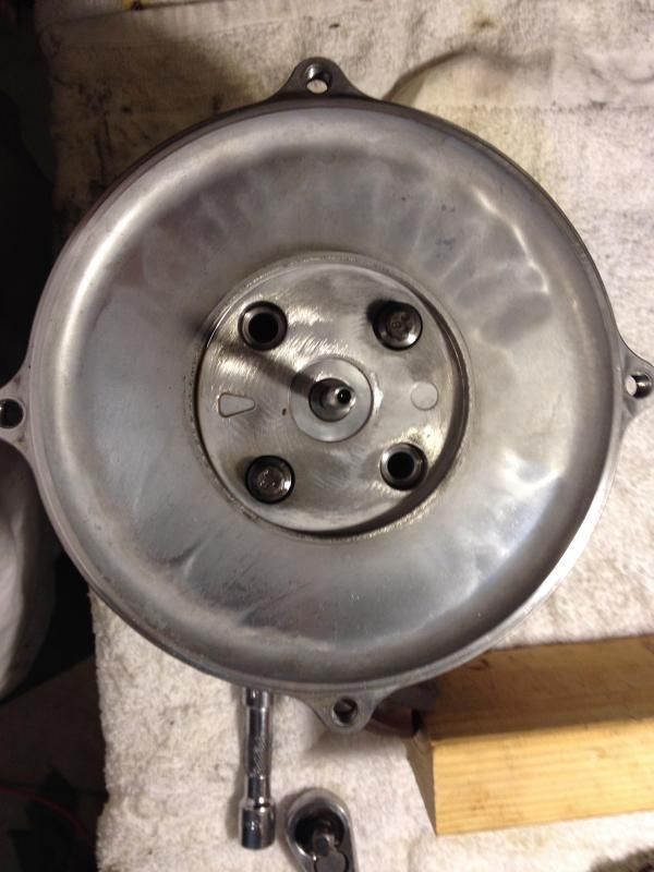

Huge gash wth.....
What on earth could of got between the wheel and backplate? All 4 bolts were damn tight..

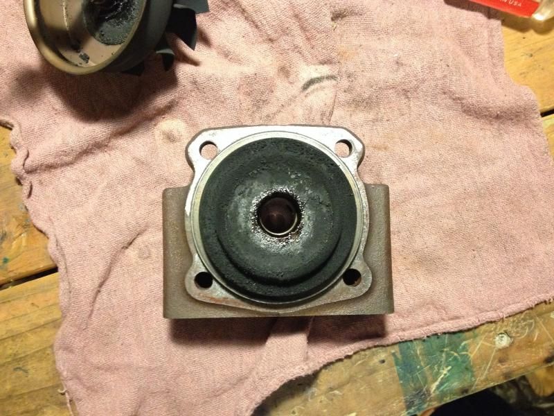

Exhaust plate or whatever.. Oil was deffinately getting threw.. Wasn't enough to make the truck smoke at all..

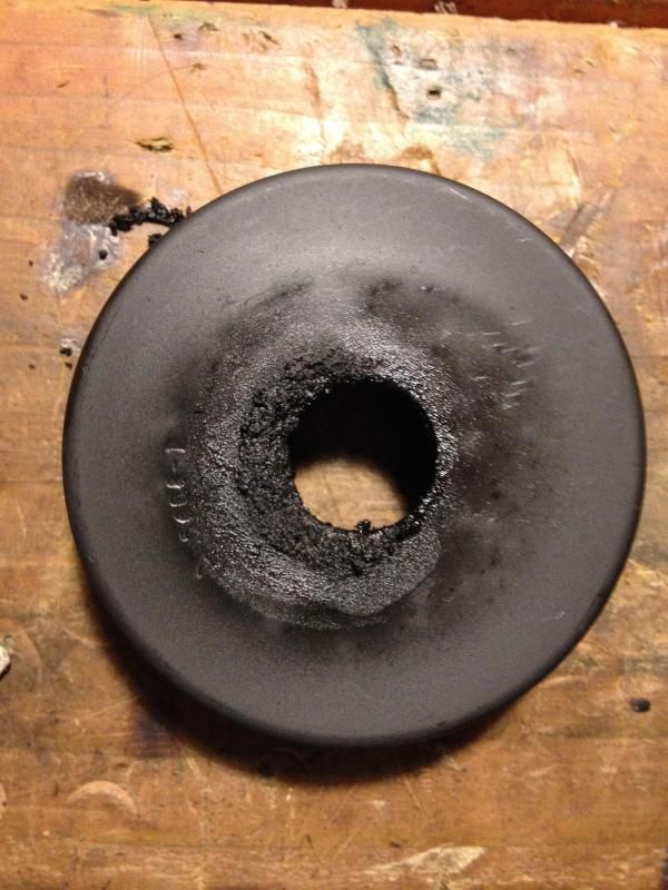

All gunked up!! Damn.. Why tho?
Nasty.. It's like chunky dirty burnt oil, that hole isn't perfectly round anymore..
Deffinately signs of excessive heat on back side of compressor wheel and where all that gunk build up is.. The exhaust wheel itself looks fine nothing has hit it or has it rubbed anywhere..

I don't think that's a gash on the back of the wheel. It just looks like an ugly balancing job.
I'd say order the 360 rebuild kit and a wheel and have at er.
