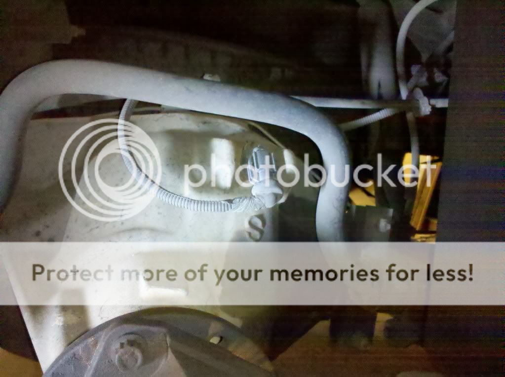

Hey guys. so one thing has been leading to another with my truck this week. last night on my way hope i lost all dash nights and marker lights. turns out my number 8 under hood fuse blew im getting a short from some where. thismorning on my way to work my abs light came on and my trans O/D light started flashing. i figured i would see if anyone has had this problem before i start digging. any help is appreciated!
Old 11-01-2011, 04:08 PM
Join Date: Feb 2007
Posts: 35
Check your VSS. It is located on the rear diff. You may be able to pull it and wipe the gunk off, or replace it. Pretty cheap to get an OEM part, usually around $20.

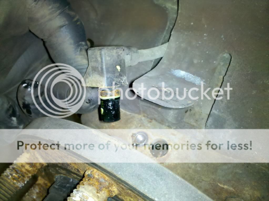

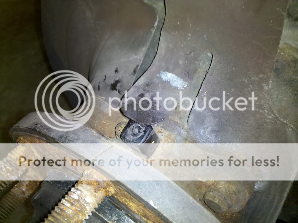

loosing hope
anyone know where pick ups for ABS are on front wheels ??
Old 11-19-2011, 09:28 AM
Join Date: Feb 2007
Posts: 35
The ABS Sensors are on the axle knuckle right between the shield and the rotor.
