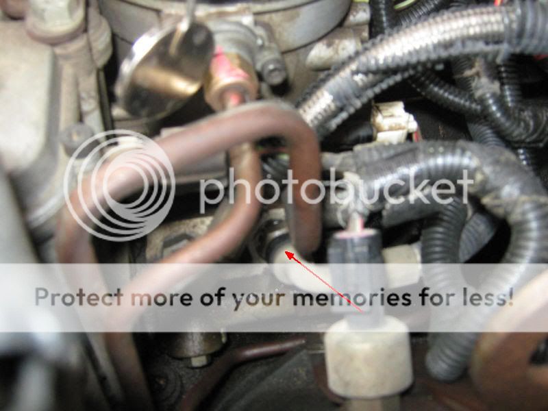

I wonder if maybe the ICP sensor is going out. You can check it to see if there is oil inside the connector.

Oil level is good and not running a chip. Where is the icp sensor?

ICP.facing the engine,it will be on the driver side ..to the right of the fuel bowl.It has the quick disconnect on it.You can see it in the pic.
The pic is one I found..it is the one where the arrow starts from...it is actually pointing to the bottom of the HPOP.Not the OIL line.

I pulled the connectors on both valve covers and checked the resistance, checked out good. I will try to take a look at that icp tomorrow, thanks for the info. If all else fails I'm going to have to leave the truck here and rent a car. I don't want it to come to that
