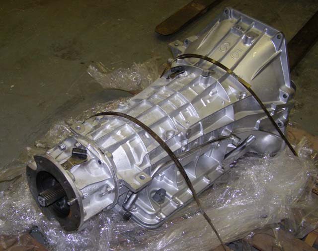

Hey, I got this transmission off of a friend and I am looking to sell it, but I am not positive what it fits. It is supposed to be for 1999-2003 or so F250/350 powerstrokes, as it was a spare for his. I found the following stuff cast on the side of it:

let's have a shot of the whole thing

that number is the trans case number , there should be another tag on the trans with 7003 in the middle can tell more with that number than the case no.

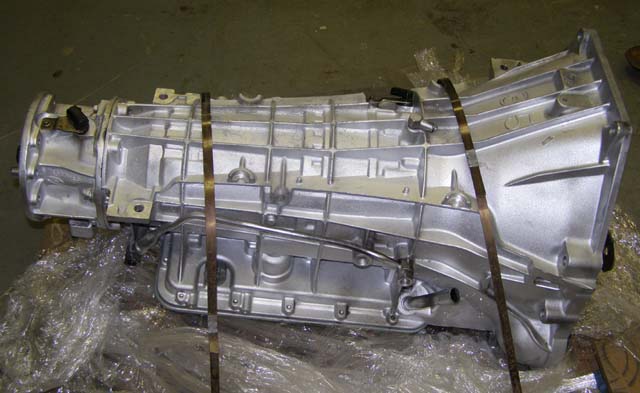

I will run back and look for other numbers. Here are some pictures for now.

It is either E4od or it is 4R100. Either way that is for a 99-2002 F-250/350. I will put 5 bucks on it. I have put 3 in my truck so I think I can reckongize one.

The only other numbers that I see are:
7A040-EB
That was located on the small splined shaft area.
Would the numbers be on that B6 tag in the first full picture?

the numbers you are looking for are on that b6 tag , mat have been rubbed off but by the pictures , more and likely 4r100
