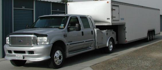

Here's a pic from August. Whole front end being changed right now (hood, grill, bumper, airdam....)
