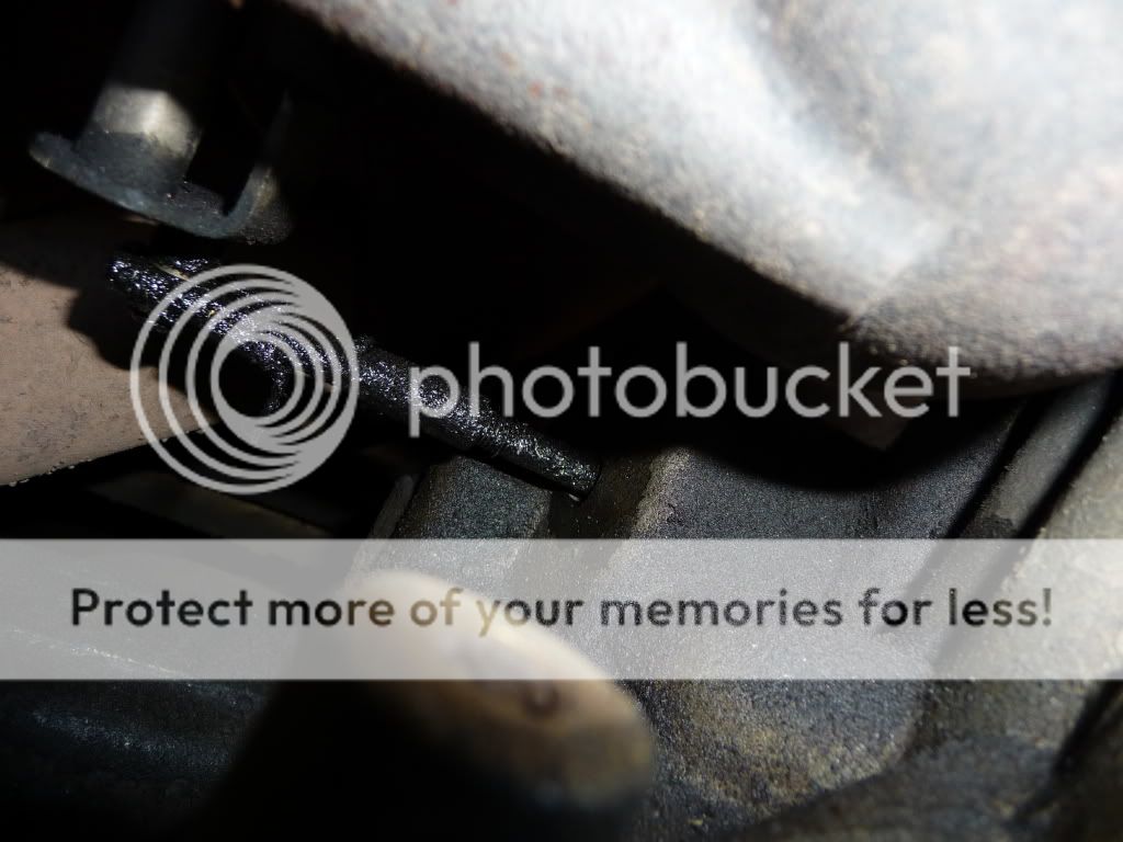

i have had an oil leak for the past 6 months and it is really annoying so i tried to figure out where it was leaking from but am having a hrd time. it is running down the back on the motor and there is oil in the valley below the y that comes off the turbo here are some pics
oil in the valley
rod below the turbo
Thank for the help
Tim

turbo pedistal o rings?

This is a typical problem with 7.3s. It's basically oil coming back through your intake manifold from the boost tubes. One way to remedy this problem is the CCV mod. PM NCHornet or Raul @ Stealth sells them now. It's basically a system that drains back to a canister & you empty it every oil change.

This is a possibility too.
