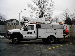

At work I drive a 05 F550 6.0 2wd with a boom.
The EX weighs in around 9,000, the F550 around 15,000 with the boom.
Stock, I am sure the 6.0 out performs the 7.3. But, the 6.0 has a huge turbo lag. This is the only one I have ever driven so I'm not sure if this is common in all. It also runs at a higher RPM so it tends to scream instead of Hummm like the 7.3. Even before the mods in the 7.3, I liked it better. Now with the mods I love it more.
