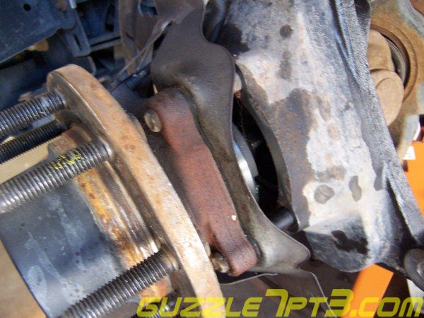

Removing hub form hub bearing assembly

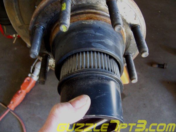

Separating hub bearing assembly from spindle
The Needle bearing the other side of pick 1 and 2 needs to be GREASED!

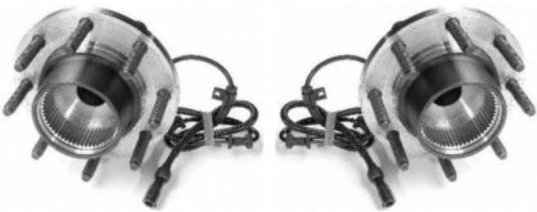

the abs sensor is on top of the hub bearing assembly behind the rotor so you will see it bolted to the hub when you remove the caliper and rotor. be very careful its only plastic i broke one today getting it out of the hub bearing. but NP cuz i had a new one that came with the new hub.. unbolt it from the hub bearing pul it out of its 3/8" hole now while spinning the hub use a grease gun to pump grease into the sealed bearing unit. its the wire in this pic

WOW, awesome, thanks, so it needs to be greased where the screw driver is pointing in the 3rd pic? There isnt a way to grease withou pulling the caliper and rotor off is there? I guess I'll just wait till I replace all my brakes in a month or so.

yeah you have to take the whole unit off the spindle to get to that bearing. not that hard just 4 bolts. grease the needle bearing and also pull the ABS sensor (sensor bolted to bearing in last pic). pump grease into the hole the abs sensor came out of while spinning the unit.
