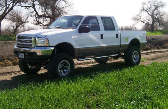

Hey guys, well i'm stuck between 2 sets of wheels right now.
First set are Mickey Thompson Classic Locks. There 18x10.
But what I don't understand is as follows.
They have a 4.5" Backspace? And -25 mm offset?
The second set are KMC XD Hoss's. There 17x9.
They have a backspace of 4.53" and a -12mm offset
Or also 5.71" backspace and a +18mm offset
Now what i'm looking for is that wide stance, i want my tires to stick out, not tuck under my fenders. Which will do so for me?

you need a minimum of 4.5" backspacing, otherwise the wheels will sit too far in and rub your leaf springs when you turn. a 10" wide wheel with 4.5" bs will stick out an inch or so from the fender, probably a little wider with your tires.

definatly go with the kmc hoss but i like your truck with the factory wheels

I don't know which way i'm gonna go. Thanks for the comp, nice rig yourself man...

The classic locks are going to work better and look much better for you.
4.5" backspacing and neg. offset are what a pre 2005 superduty needs in order to stick out and NOT rub the springs. DEF go with the 18x10s and do the beadlock ring in tan to match, they're going to look GREAT!
