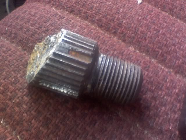

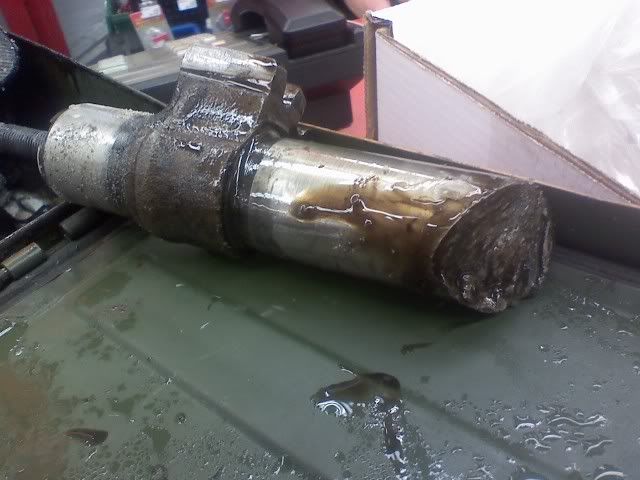

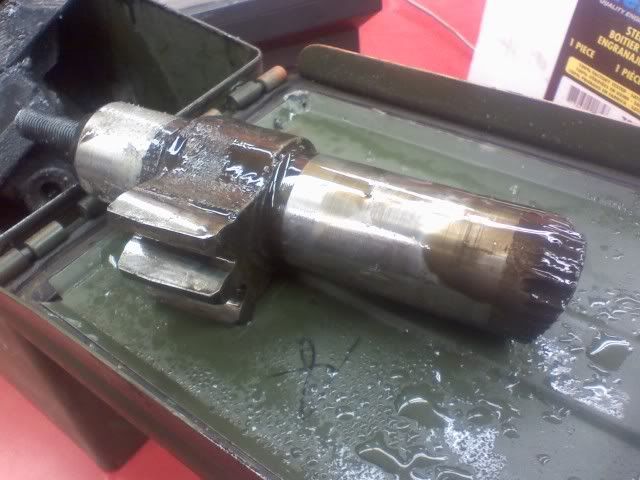

About 3-4 Months ago I got myself a new tow rig. 99 F250 With around 195k on the ticker. I knew it had a slight oil leak but nothing to terrible so I never thought to do anything about it. About 2 months ago I had the cam sensor take a **** , and got the dealer to replace it under recall. About 3 week ago I pulled out of my driveway , and snapped the steering box sector shaft.

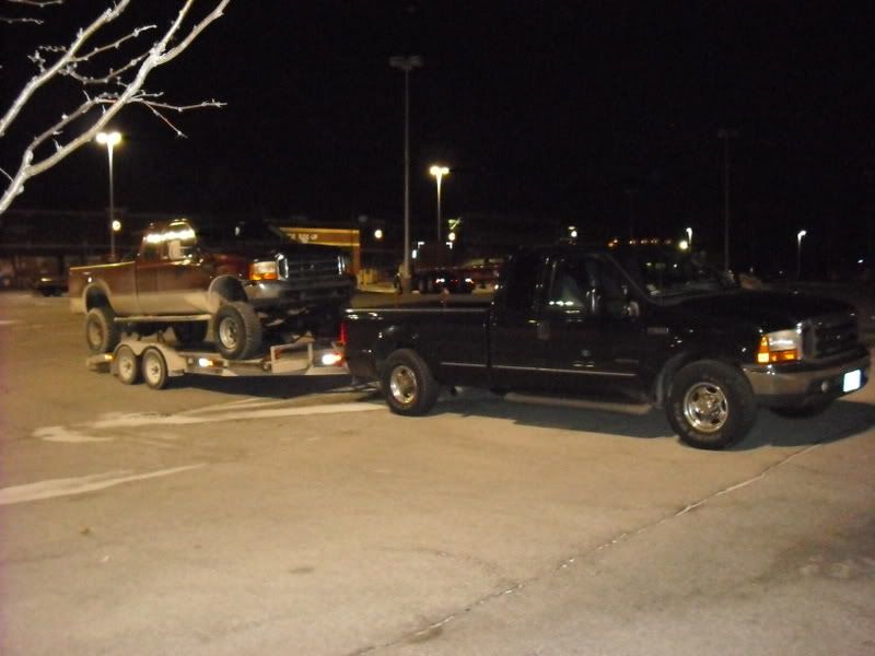

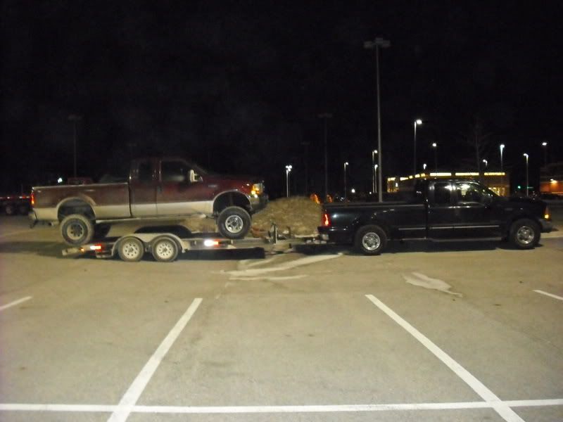

I got that fixed , and started to notice a power steering leak, and some more oil leaking. Last week I had the cam sensor go again , and my abs light is on , and I have no spedo. I still need to figure that out but I have other stuff on my plate first. I got some new Tires for it , and it looks a hella lot better than the bald ones on it did. Got some 315/75/16 Cooper STT's. They are great , and I am very happy with them. The next day ,
I wound up spending 7 hours at the Parking lot at Home Depot In Frankfort/ The eventual solution was pull k5 off trailer , and pull ford on trailer with k5.

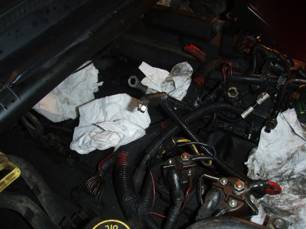

Well the oil leak got worse , and worse , and I lost 7-8 Quarts in a month so It was time to Fix that. It also doesn't like Cold weather so I wanted to look into that. Anyways the top of the engine is tore apart , and I am waiting on parts for all the seals. Replacing anything , and everything that will leak.
So Far -
Turbo Pedestal O ring set (With New Bolts)
High Pressure Oil Pump O ring set (With O ring for the Plug)
High Pressure Oil Seal (Pump to block)
High Pressure Oil Reservoir to block o ring.
Injection Pressure Regulator O ring
High Pressure Oil Rail Plug O rings.
- Glow Plug Relay , and I have 6 Bad Glow plugs so I am putting 8 Glow plug in it.
Hopefully that helps.. Well now I am just waiting on parts

yea these trucks arn't the lightests vehicles i dont think your trailer liked it too much
Old 01-04-2009, 06:17 PM
Location: Frankfort, IL
Posts: 210
Send a message via AIM to Midwestern4x4 Send a message via Yahoo to Midwestern4x4
Well 7k-7.5k on the trailer plus 1900lbs on the trailer it self..

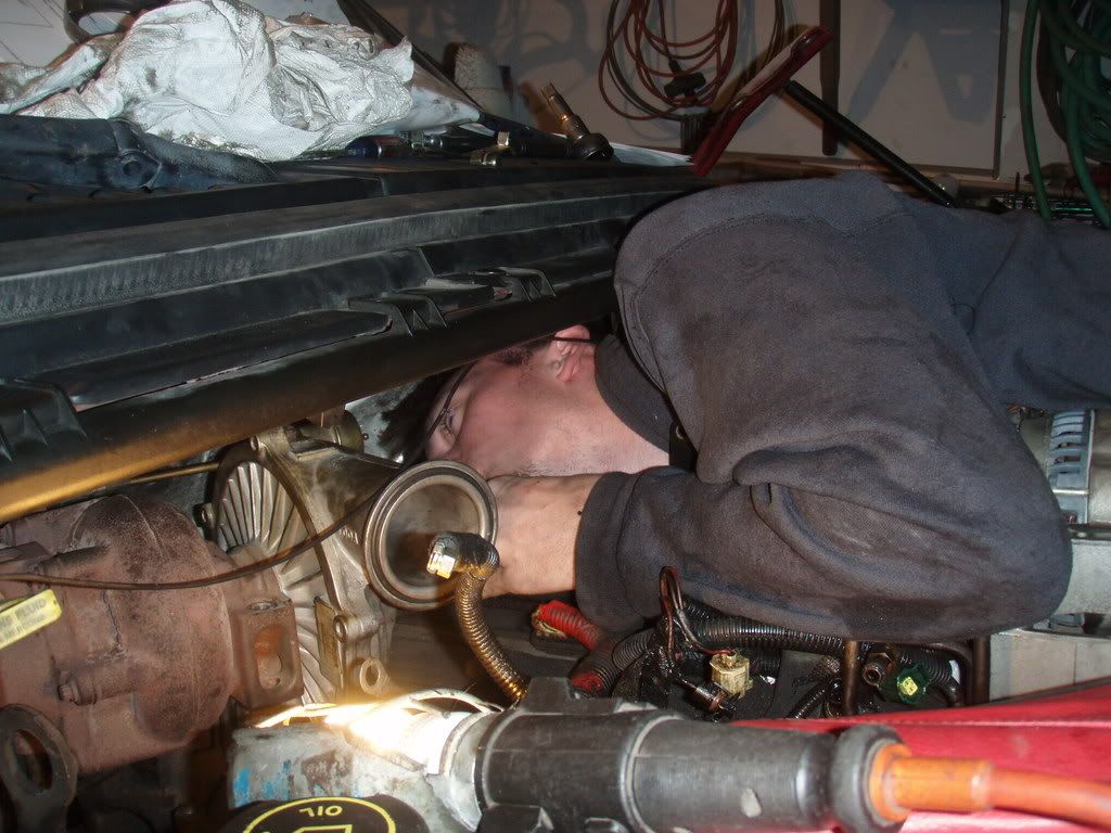

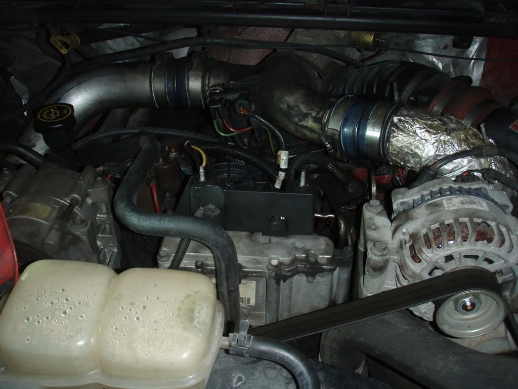

The speedo problem is probably the VSS on the rear pumpkin, $30 and 10 min to fix. If it threw a code check them. Not sure why you tore the top of the engine apart, my bet is you simply had a bad O ring in the HPOP line. And what in the H*** are you doing to your turbo in that one pic near the bottom,lol!!!! Anyway hope you get her fixed up.
NCH
Old 01-05-2009, 05:52 AM
Rob Rob is offline
Location: Layton, Utah
Posts: 13,238
NCH
hes givin it a kiss goodnight!!!
