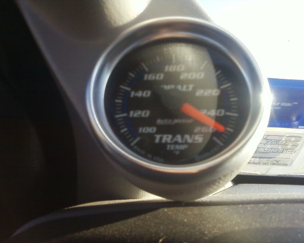

Old 12-15-2008, 12:54 PM
Location: Pasadena, TX
Posts: 6,514
ah heck, I wouldn't worry about it until you see this
Just kidden. Sounds like NChornet has you lined out
