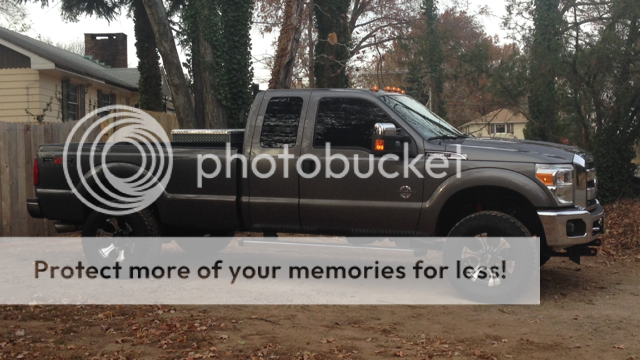

2011 F-250 SCLB XLT 6.7 Powerstroke
-H&S Minimaxx
-H&S EGR Delete
-Flo-Pro 5" exhaust
-Airaid intake
-Fisher 8.5' Xtreme V SS
-OUO traction Bars
-Dick Cepek DC-2, 35x12.5R18 Toyo A/T II
