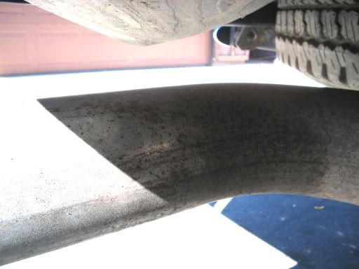

BEFORE
Lots of corrosion on exhaust surface.

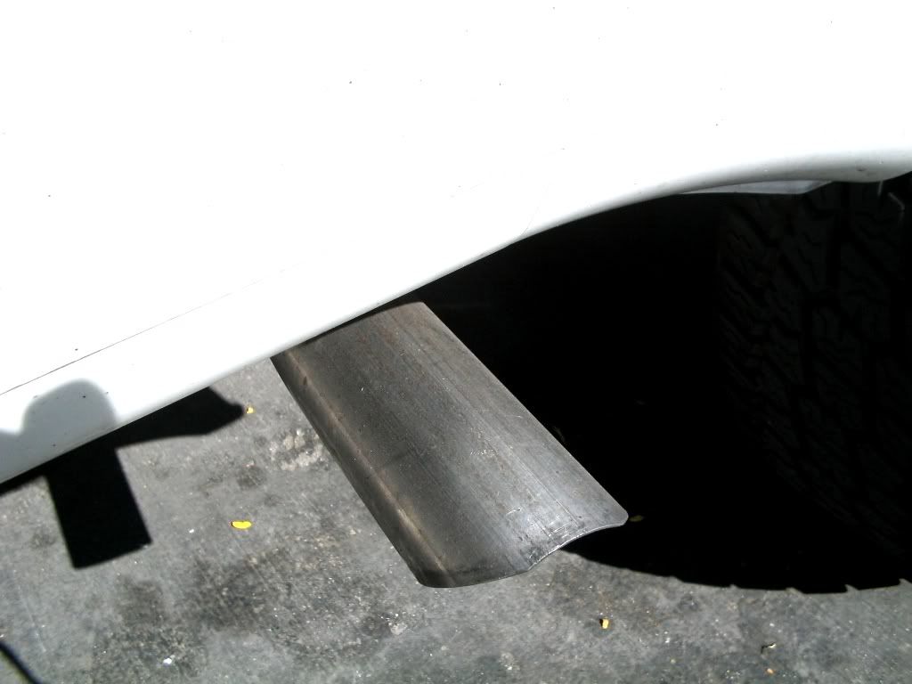

AFTER
Pretty decent shine
Materials Needed
Club Soda
Aluminum Foil
Directions
Pour club soda directly to tip.
Using straight back and forth strokes with grain of pipe, scrub vigorously with a ball of aluminum foil.
Keep changing surface of foil as you scrub.
Wash off greyish opaque liquid with more club soda.
Once desired shine, dry off and apply coat of WD40.
Tada! even old trucks can have a shiny exhaust tip.

i did that to the grill on my '77. but i used coke instead and the grill was aluminum. good idea!!!

neverdull and steel wool will do the same thing, it'll just corrode again anyway.

looks good for now. . . hehe
