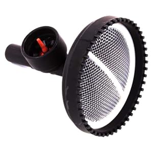

This is your problem
E5TZ-9J306-BA "Fuel Tank screen" (about $42 from ford)
its a rubber part, gets hard and breaks up
When it fails you start running out of fuel at 1/4 of tank, will cause electric fuel pump failure if not replaced
Easiest access to Tank is to remove the bed (6 torx head bolts) then spin off fuel sender cap, and pull sender unit
You don't even need to disconnect the fuel lines to replace the screen when bed is removed
You'll need a 24" strap wrench to remove the sender cap
