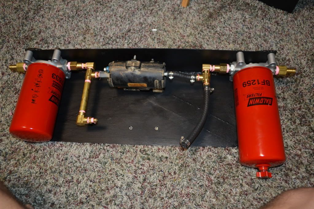

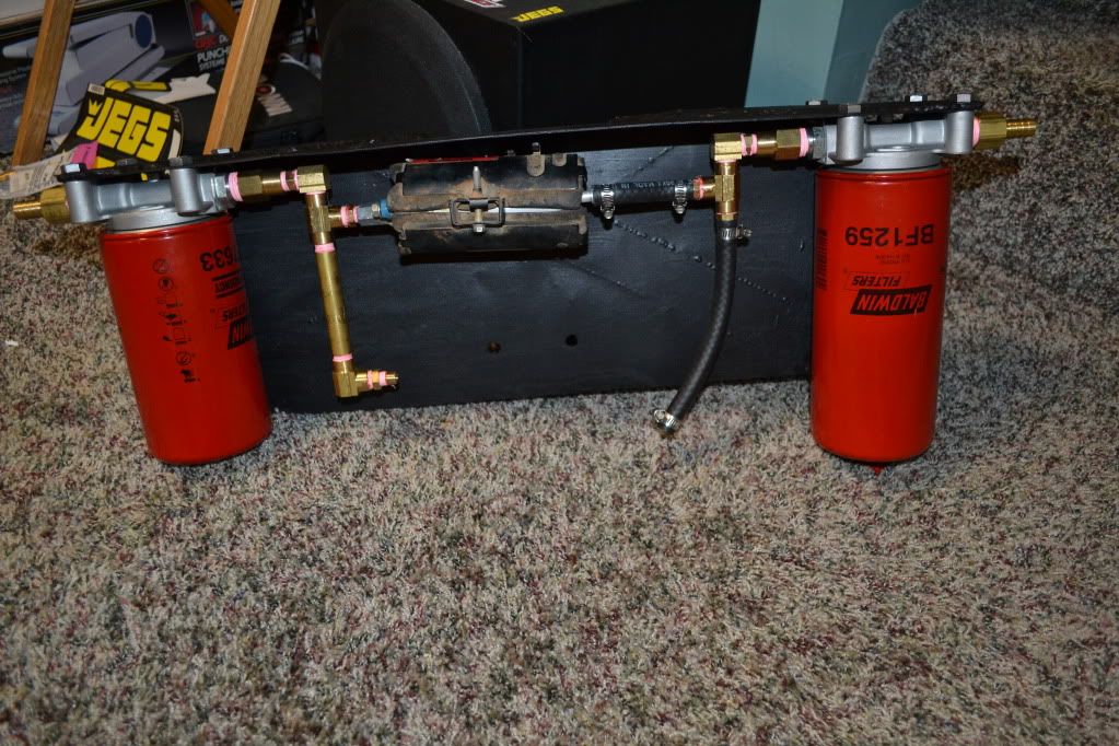

Hey I am building my fuel system and i just ordered my strictly diesel fuel bowl delete and regulated return and just finished my pump and filtration system and i think it came out pretty cool what do you think?

I am debating doing this to my 7.3 in the spring...I did something similar to my dodge just one dumb question. Why the T's pre and post pump? Fuel return?

Dual pumps I bet.
I'm going to do this. Actually have a lot of stuff already but I'm going to use filter heads that have dual in and outs. I was going to get some check valves in case one pump goes out, then the other pump won't try to go backwards in the system.

don't the stock pumps have one way check valves in them and they can't flow backwards anyways. but yes the other tee is for another stock pump for now eventually i will replace both pumps for one big pump when i can afford it haha but this was cheap for now

Heck idk. Maybe they do. Try forcing air or something backwards through one. Cause my other stock one isn't here.
Heck, after seeing yours, I just might change my idea.

ya thats what i did but i couldn't thats why i didn't worry about it haha also when one of them goes i will just get one bigger pump. but ya i haven't installed it on the truck yet but it seems like everything is going to work out well

Mine is going to be all mounted straight inside the frame. Filters and mounts, pumps, just straight to it. I like the whole 'mount it all to a plate then plate to frame' Idea.

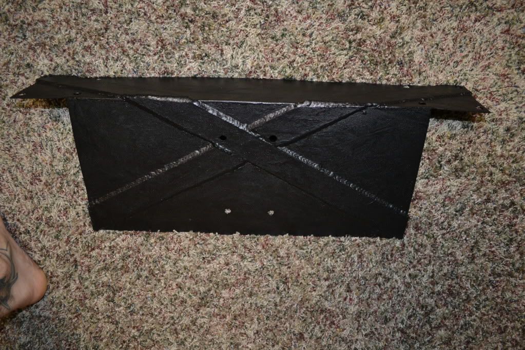

OK, TOTALLY off topic,,,, but Dude -> WTF is That? in the Lower/LeftHand portion on the bottom pic???
Is that a tattooed human foot? Ankle? Elbow?? I can't make sense of it!

haha ya it is my foot with a shark tattoo on it haha thats it
but ya i wanted to do the whole mount because i can build the whole system except the last pump and get it all plumbed and then less down time for when i go to install it
