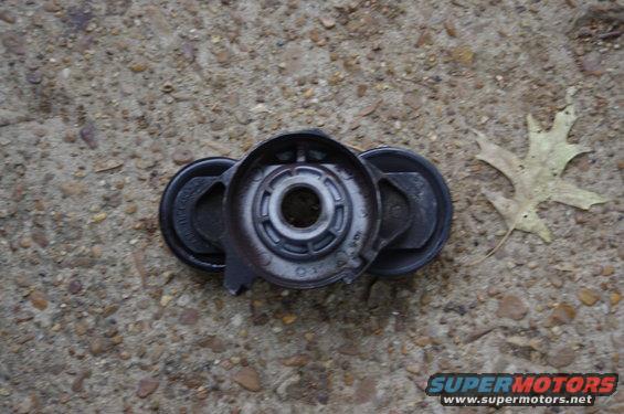

I was heading home from buying me a new emblem at the ford dealership yesterday when my truck broke down on the side of the interstate. Turned out my belt tensioner broke completely off the motor and in process the belt shredded and ripped two power steering lines in half. The center bolt that holds the tensioner was still in place was still in place and tight. Looks like it just broke off around it. Luckily it fell off and bounced to the shoulder and not behind me into a car. Anywho after a couple hours I finally got it fixed. Went good for me since I have two trucks so I just drove my bronco to fix it. BTW its tough working on a vehicle on the side of the interstate. Just figured I share a crazy story with you guys.

odd. Ive lost my Idler Pulley acouple times on my 95. Never a tensioner.. Glad everything worked out ok though

just dumped an 04 Ex, mine broke in half in Red River new mexico. PITA

This is a common enough problem. Usually a bearing goes on them, but I have seen a few snapped off. Glad you got it fixed.
