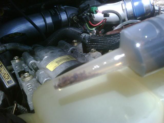

I always forget to open the relief valve first but I don't have issues. Remove the plastic cover and it can come off easy with a long extension and a light tap.
Clean out the bottom of the bowl as best as you can, it gets real gunky at the bottom.
This was sucked out from the bottom of the bowl.
