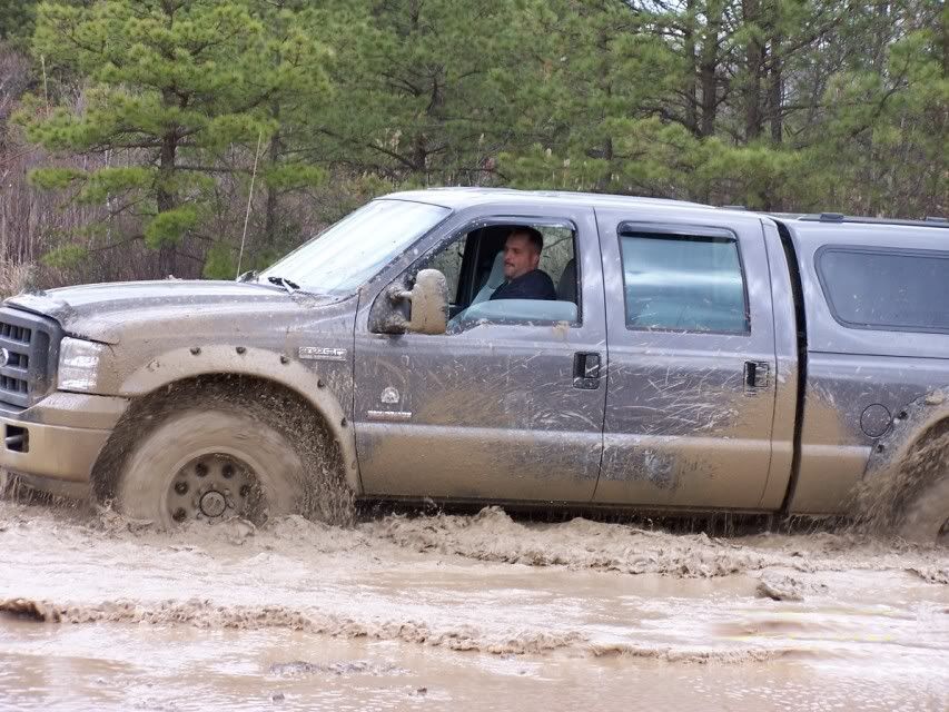

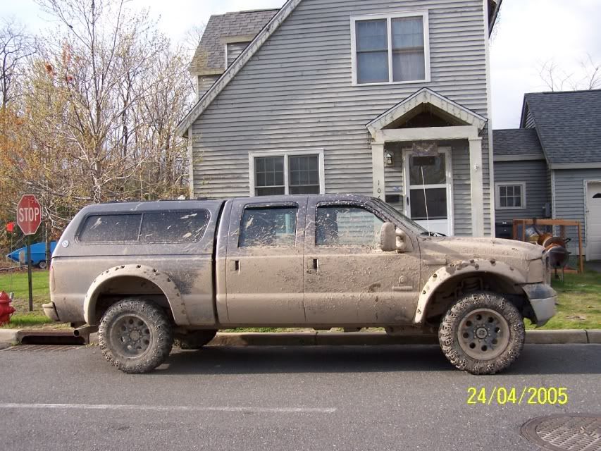

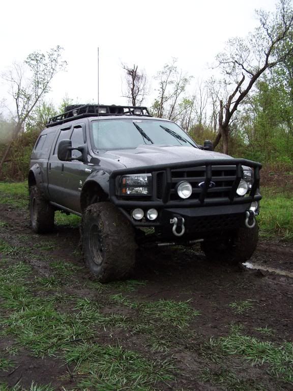

It all depends on your driving style..
hardcore offroad...36"
mild offroad,..mostly street...37"
street queen....38"
But even then is depends on the brand of tire you choose,...some run wider than others..
And ....my definition of "FIT" and other peoples definition of "FIT" are different....
no lift, cut-outs and 36's
4.5" lift, cut-outs, and 41's.....don't fit,......extremely minor rubbing on radius arms.
if it rubs even a teeny tiny bit,...then it doesnt' "FIT"
