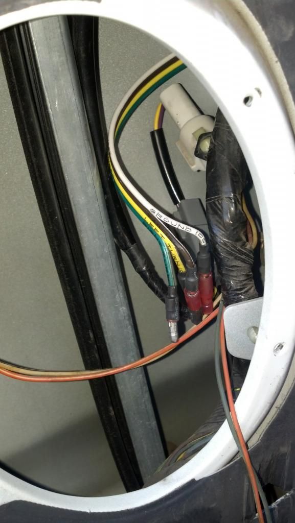

wiring with connectors in case I have to ever pull the mirrors
door wiring complete

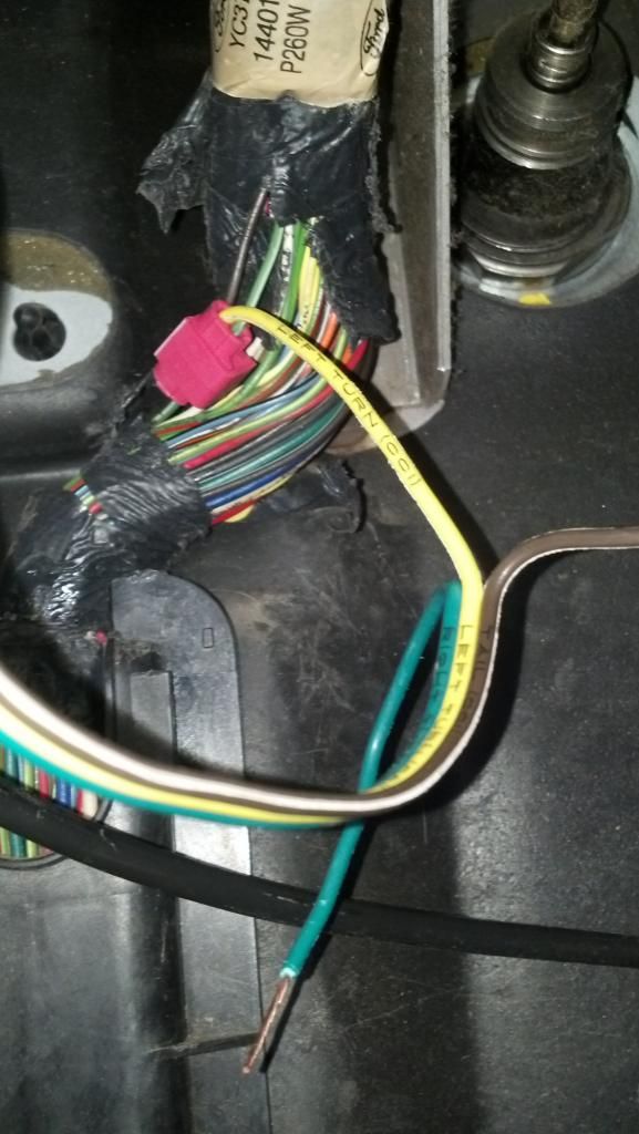

I took the advice from previous installs and pulled power for the running lights and turn signals from the wiring harness under the steering column

The wiring is pretty easy. Ground, heat 12V, turn signals and running lights. That's it. The early trucks didn't come wired for heat and lights. I think the newer ones are plug n play.
