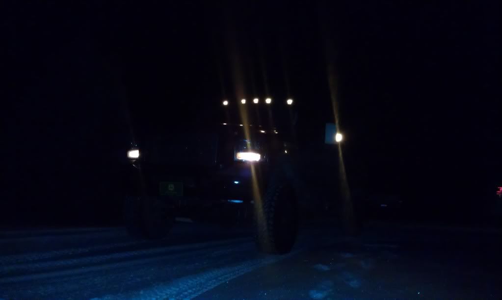

well guys i finally got my 05 front end on. i also did cab lights the night before and wired up my lighted 03 mirrors i got from Matt_P
it went from this
to this

I ran the wires through the door on both sides, and through the rubber boot, then there is a gap in the corner of the cab that you can run wires down to a little hole at the bottom right by the floor. i did that for both sides and for the passenger side i ran them up through that kick panel then behind the glove box and up under the dash to the other side. i cheated and used quick connects because they arent going to be exposed to the elements
