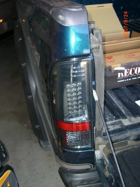

Out of the box:
Old Lights

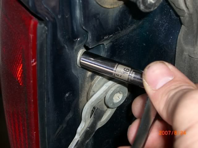

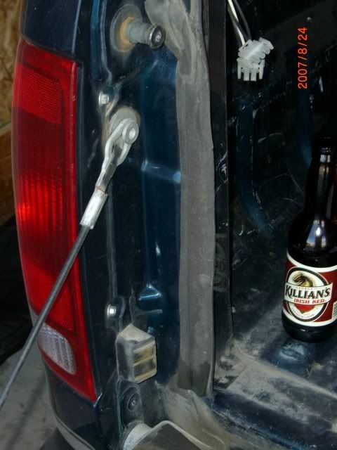

Okay, Drop the tailgate: get a 5/16 socket and take out the two bolts holding em on.
Pull the light off of the truck...it will be rather difficult but it will come. Just take your time and be careful. This is what you get:

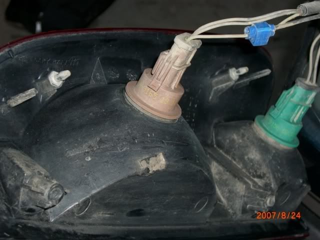

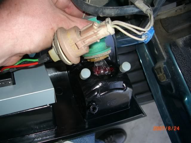

Turn the bulb holders and remove the old tail light. Then take the bulb out of the top fixture (brake light)
Take the new Recon Tail Light:
Plug the connector into the empty bulb socket.
Check to see if it works; if it doesn't just unplug, rotate the plug 180* and plug back in.
Plug the bottom bulb in as well as the one that you just connected.

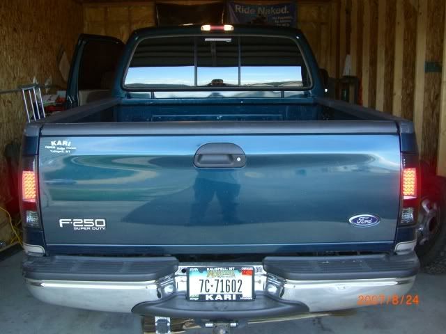

Now reinstall light
Now check again when all installed and here you go.
Start to finish, including taking pictures: about 30 minutes.
