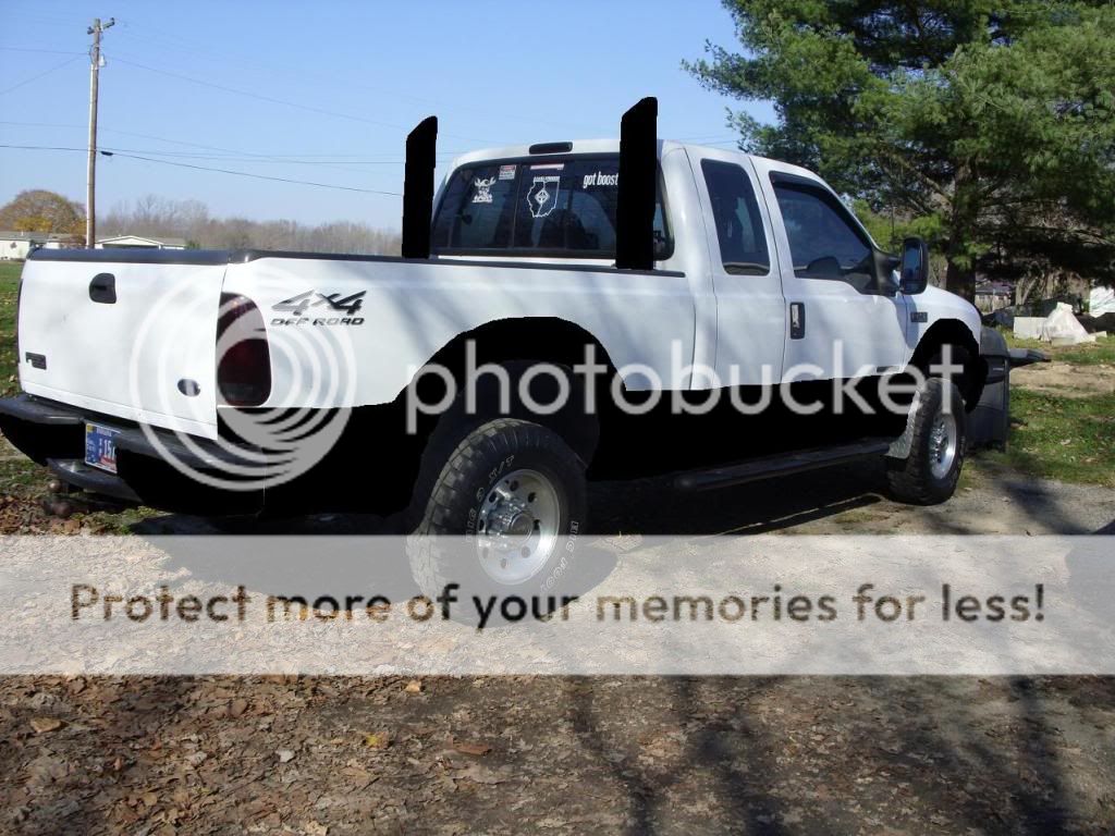

Posts: 7,871
this is the only pic I have and its a bad one. I was playin with photoshop.. not good at it just getting ideas.
