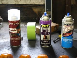

1) Here is what you need i got 1000 grit sandpaper and used that too.

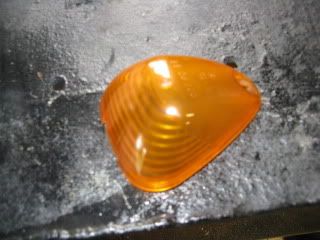

3) I sanded them with a soap and water mixture to get the wax off of them
4) Wiped them down with acetone to get the other gunk off

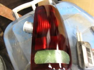

4a) Then I taped off the areas i didnt want the spray
5) Then I used Dupli-Color ADHEISION Promoter to make it all stick
6)This is Them Sprayed with the Promoter
7) Paint them with the VHT Night Shade Spray The Tail Lights I used a light coat and on the 3rd brake light as well. The Cab lights took more as they were orange.

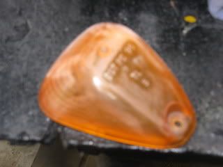

8) Lights Sprayed
8) This is with a light coat on the Cab Lights.
9)After They Were done I hit them with some Clear Coat maybe 2-3 light coats
