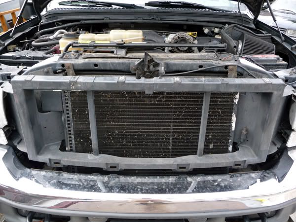

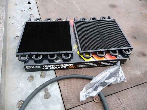

Now what's your take on this guys? The trans oil cooler is in my radiator & this guy tells me to disconect it & fit 2 oil coolers up front behind the grill. I bought 2 oil coolers from him & have started the mission of fitting them.
Have any of you done this?
He said it is a bad idea to use the cooler in the radiator incase of a fracture & water/anti freeze get into my trans & wrecks it.
My truck is a 2001 F350 7.3 I notice there is another cooler for the trans inbetween the aircon condenser & the intercooler. Anybody know if this is stock or if it must of been fitted afterwards?
This is the trans cooler lines into the rad.
This is where I'm going to fit the 2 coolers.
This is the coolers I'm fitting.

The small cooler you found in between the others IS your stock cooler. The "cooler" built in to your radiator is not as much a cooler as it is a "heater" to warm the ATF up to the 150* or so required for it to function at its best.

o I see. So do you think I should leave it conected & just add the 2 coolers? The thing is I tow 95% of the time & I travel all over Europe so I can't take any chances on things going wrong.
