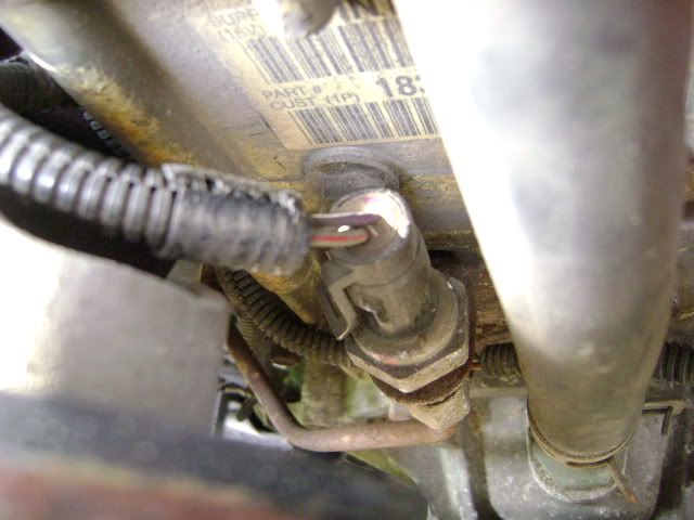

But what exactally is this? Its been causing a chattering sound at higher RPMs and I just found out today that this is the problem. It is rusted off of the manifold.

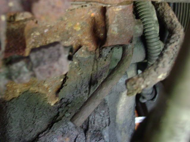

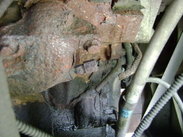

And this is where it leads to.

That's your exhaust back pressure sensor. You can get a replacement exhaust back pressure tube from the dealer. I'd also check the sensor and make sure its not clogged with soot as well.
Alrighty thank you.
Originally Posted by dzchey21 View Post
holy rust bat man
Trust was a former salting/ plow truck. Underneath is pretty bad.
