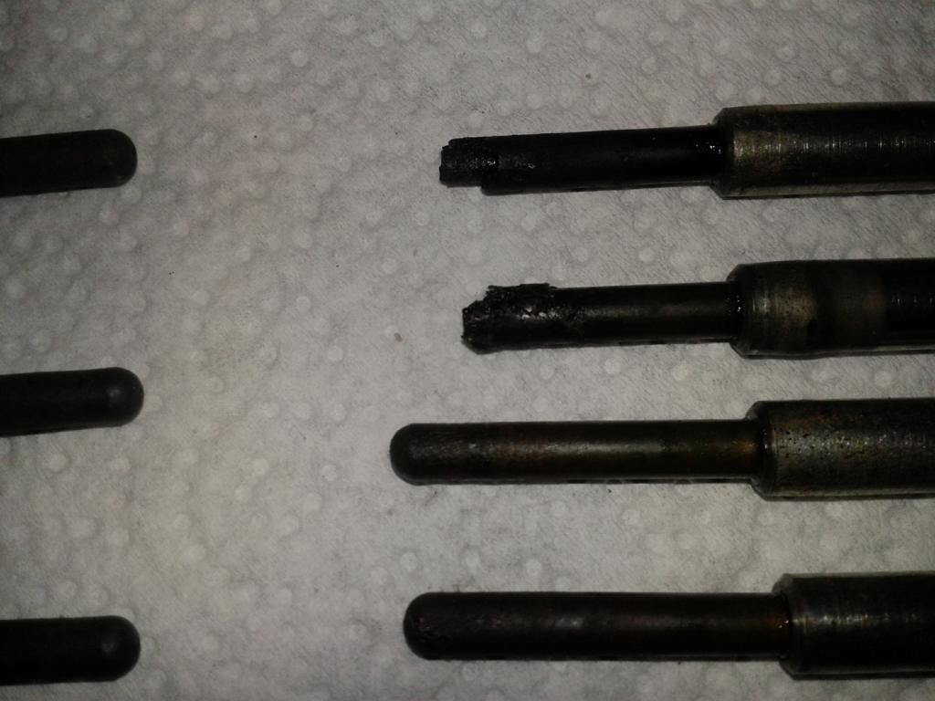

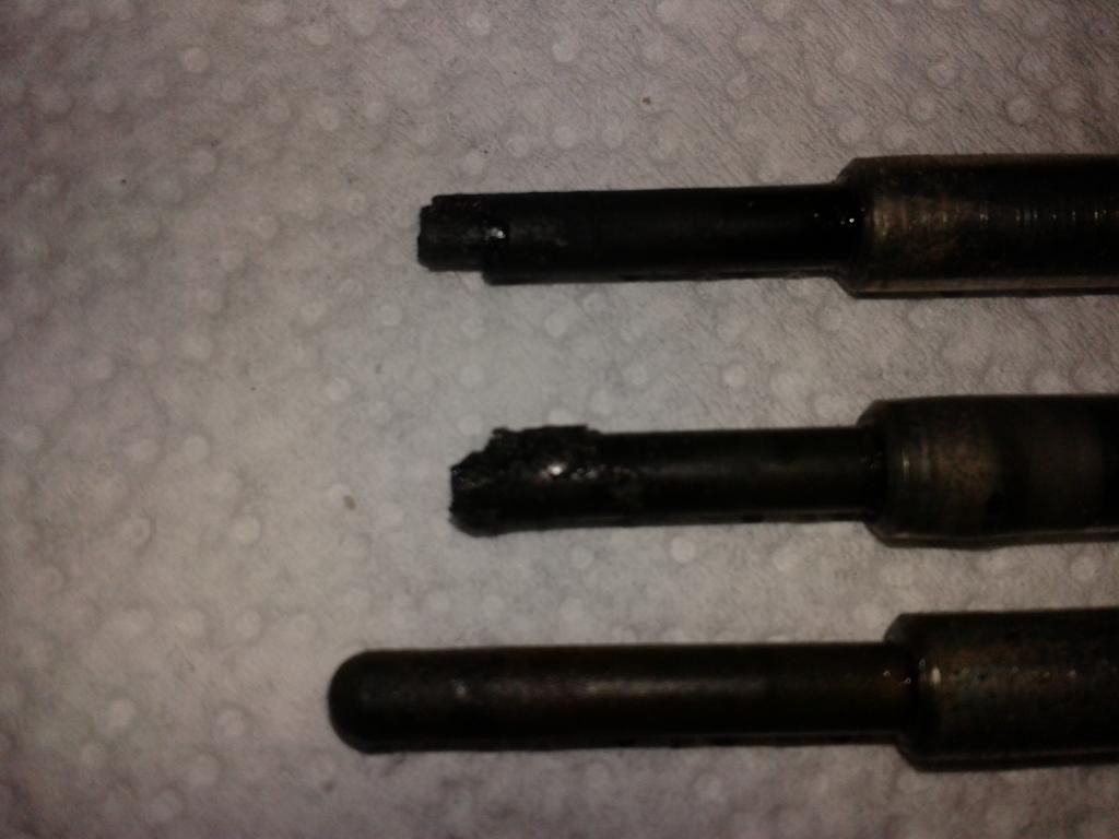

Glow plugs came out with very little resistance. These thing were in no sense of the word "tight". My concern is, two of them (#1 and #3) came out with about a quarter inch of the tip missing!! Is this common??

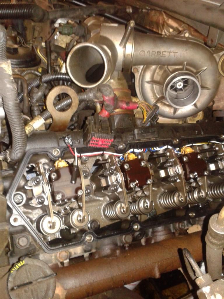

Any advice would be appreciated!! Here are a couple pics, the glow plugs in question, and the pool of oil left in the intercooler pipe.[IMG][/IMG]

Looks like a good project ... Just my opinion, but it looks to me like the broken ones have already been run with the ends broken off - the ends are oiled and sooty with exhaust.
I'm not sure if these are ferrous/steel or not - but did you try a small magnet and fish around - if accessible to get a thin magnet in there through the glo plug hole?
Not familiar enough with the 7.3 to comment on the other issue of fuel / oil mixing. But on the bright side, it looks nice and clean under the rocker cover.

Glow plug hole is pretty small. You're right though, I didn't think about them being so sooty. They probably went away a while ago.
