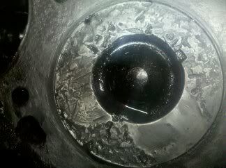

never mind I fixed it #6 injector was failing and UVCWH was bad on drivers side changed and all is good
