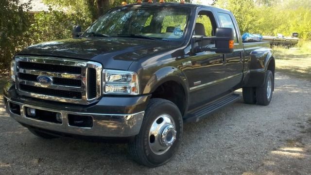

I have a 2002 f-450 with a 7.3 that will just die out after about and hour of driving just as if i shut the key off. After it dies it won't start right away but after it sits for a while it will fire right off. cam sensor is new. Any ideas?

Next time it dies get out and check your hpop reservoir. My injector o-rings are shot and when I'm slowing down off the highway, sometimes they will bleed too much pressure and the lpop cant fill the reservoir fast enough, I run out of oil, no oil means no firing of injectors. My case is rare but its worth a shot.
Does it act differently, any smoke, weird noises? What color cps did you put in?

it doesnt act differentely at all its just like i shut the key off. the CPS was black i believe.
