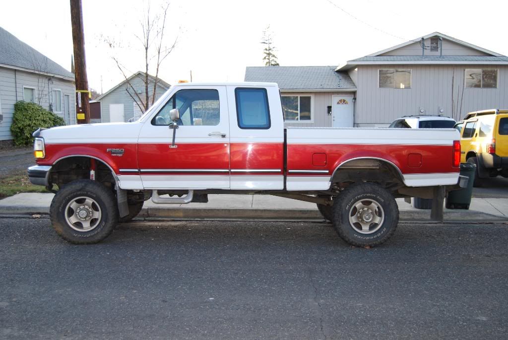

Location: lewiston, Id.
Posts: 5,010
well it was sposed to be a 4 inch when I got it but it lifted it way more than 4 inches. it came w 3.5 inch blocks in the rear and I had to do a shacle flip to give it 5 total inches in the rear to sit level.

Originally Posted by rankroddin250 View Post
no issues.
thats a cute lil truck bud
